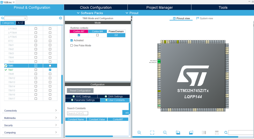

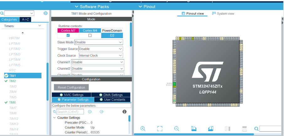

you'll need to assign the TIMER to the respective Core first.
0693W00000HocHXQAZ.pngthen the TIMER will be available for selection.
0693W00000HocIBQAZ.pngPS: the screen shot are from STM32CubeMX 6.4.0

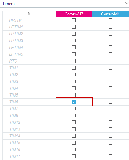

Hi @MDeva.1​

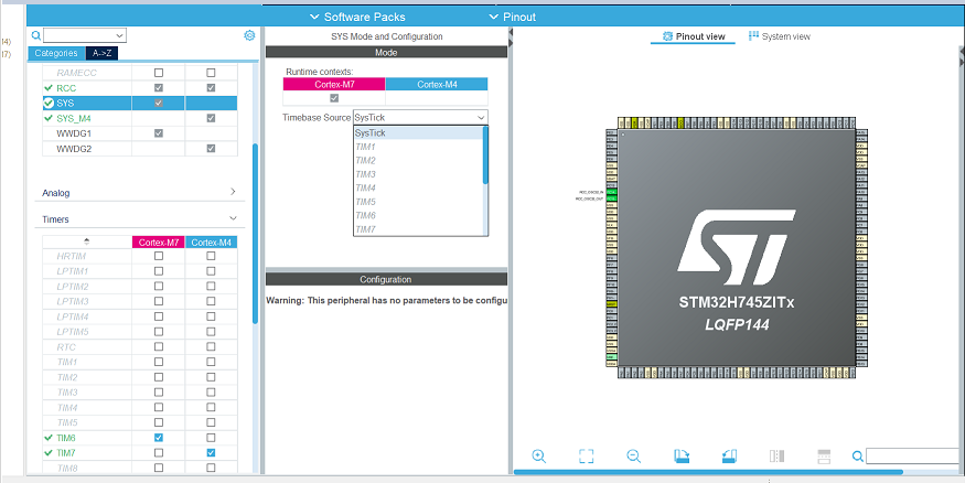

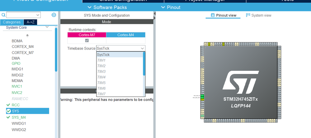

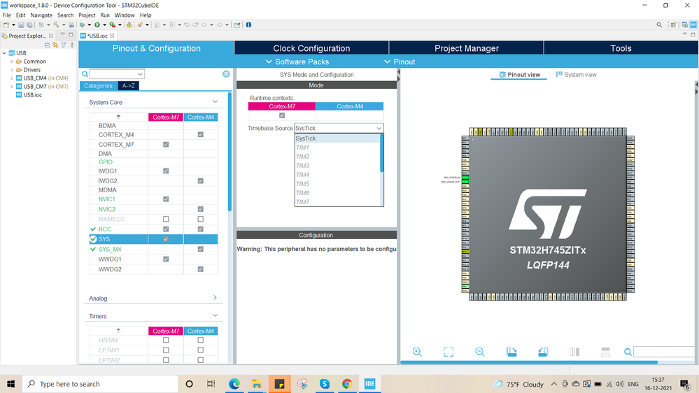

I am working on NUCLEO-H745ZIQ board. I am using the STM32CUBE IDE 1.7.0. According to you first I setup the TIMER to particular core ,after I tried to set to Timebase source but it doesnot allow me.I am sharing the snap shot.0693W00000Hoj3nQAB.png0693W00000Hoj4uQAB.png

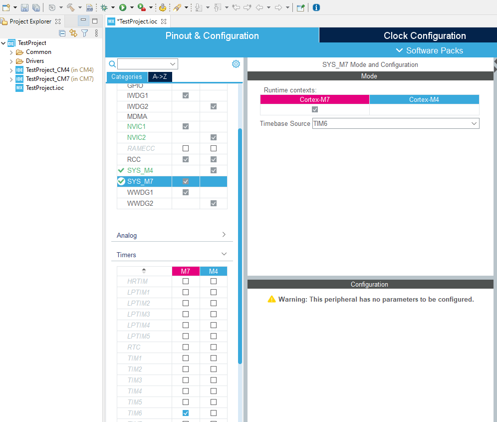

Haithem Rahmani
December 15, 2021
this screenshot was taken from STM32CubeIDE 1.8.0, the TIMER 6 is correctly selected as time source for CM7

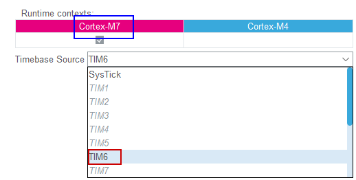

0693W00000HookCQAR.pngHello ,
I install the latest version 1.8.0.I am sharing the snap shot 0693W00000HoogyQAB.png0693W00000HoogoQAB.png,it doesn't give me the selection for TIM6.
Haithem Rahmani
December 16, 2021
it is because you checked the "Activated" Checkbox, that option means that you want to use the TIM6 at your application, unselect that option and this will be fine.
