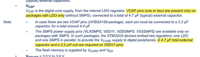

I am referring to the note AN5373 and MB1550/1549 schematics to design a STM32U575xx based board. The note AN5373 shows no connection for the VLXSMPS and VDDSMPS  pins when SMPS is not used. Do i just leave them floating? How should I connect them if I do not want to use the SMPS? Also there is no 'VCAP' pin on my symbol.

Connect them to GND, per the Reference Manual.
What is the full part number of the chip you are using?

I am using STM32G474VIT6Q.
That is not a valid part number.
Sud_09
I apologize, STM32U575VIT6Q  is the part number.
My first reply should be what you need then. VDD11 are effectively your VCAP pins here. A 2.2 uF cap bypassed to ground on each pin will work.
