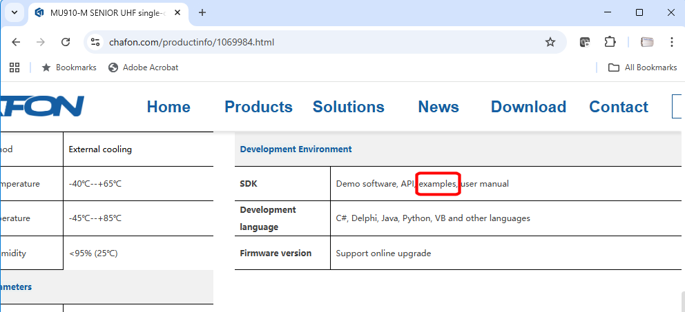

@Navya wrote:
CHAFON MU-910 M RFID Reader Module
You mean this: https://www.chafon.com/productinfo/1069984.html ?
It's always helpful to give a link - so people can be sure exactly what you're referring to.
@Navya wrote:
We were asking for any sample projects on establishing UART communication with RFID reader modules similiar to CHAFON
A UART neither knows nor cares what it is connected to - it just sends & receives bytes (characters).
So, once you can send & receive bytes between your STM32 and PC terminal, that it will work with any other UART-based device.
You can find UART examples for STM32 in STM32CubeIDE ...
