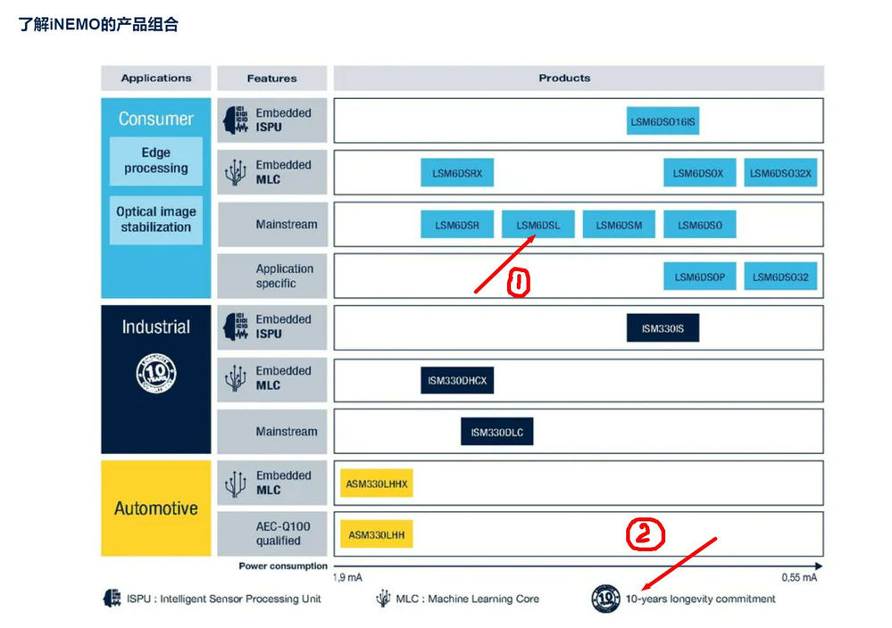

xwang.6
Is the life cycle of the part LSM6DSL similar to STM32F103CBT6?
Following this table :Inertial Measurement Units (IMU) - iNEMO inertial sensors and modules - STMicroelectronics. It seems that this LSM6DSL is no part of the 10 years commitment.
However you are un the MCU community forum so I have not so much information. If you want more information, please contact the customer support dedicated to the LSM6DSL.
xwang.6
xwang.6

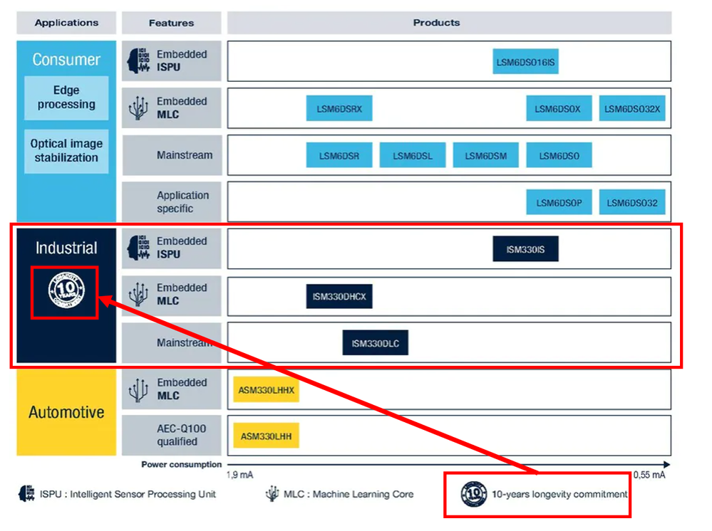

LSM6DSL is also a 10-year commitment, according to its website
I think you are misreading the table. The 10-years description below is a legend and not for the whole table. So following this table only industrial product has the 10-years commitment.
xwang.6
You are right. Thank you very much!
