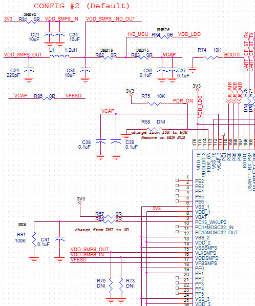

we are using STM32H755IIT6 MCU we made 5 boards with the same MCU STM32H755IIT6 all the board can be programable with verification but only one board of start to run what we can check on the board to find the problem

0693W00000KZqBpQAL.pngwe are using the SMPS as the schema

Shouldn't VCAP capacitors be 2.2uF each, not 100nF?
Double check PDR_ON expectations​.

we did add capacitors on the VCAP
we did try to use external VCAP (1.2V or 1.1V) and the same

We did change the capacitor and it doesn't Help

yes we are using SMPS

Board bring-up tends to be the primary responsibility of the engineering team who designed it. And might require significant due-dillegence work to go over the design again, pin assignment, PCB, PCBA, netlists, etc.
So if understand the current state of things you can program and verify all the boards. This suggest code is running, but not necessarily well, and it likely either running from ROM, or stuck in some while(1) loop. The boards are at least semi functional.
The trick now would be to determine if the code is executing, and how deep it's getting.
The parts will run out of reset, you don't need to set any clocks or plls.
I'd start by adding code at the Reset Handler to set/toggle a GPIO, and then work deeper into the code flow to see how far I can still see signs of life.
Would do it in assembler, and I'd likely try to get a UART up next as a means of reporting status from within. The H7 should run at 64 MHz via HSI, so use that for baud rate computations.
