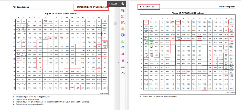

Hi there,
My major devices are STM32H747XIH and STM32H743XIH.
I prepare to design a board.
This board can be replaced with these two devices each other. (Two devices share this board)
As I knew about hardware, these two devices are diffenet only in SMPS pins.
These are my design. Could you help to review my design, is it correct?
I will supply power to VDDLDO 3.3V and VCAP connect 2.2uF capacitors.
SMPS pins let them float. Only use LDO supply power to Vcore.​
If any comments and suggestions, please let me know.

Hello @fastfret​,
I suggest checking RM0399 section 7.4 Power supplies, Fig22 System supply configurations, VLXSMPS should be floating.
CYANG.1
Hi
VSSSMPS pin needs to be tied to ground.
