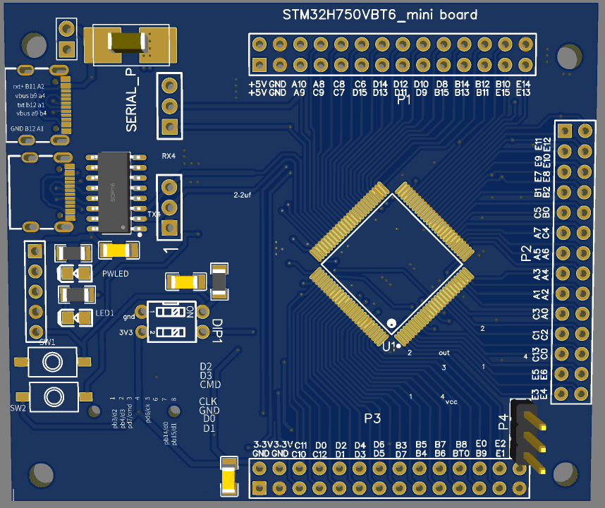

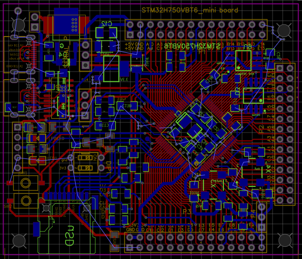

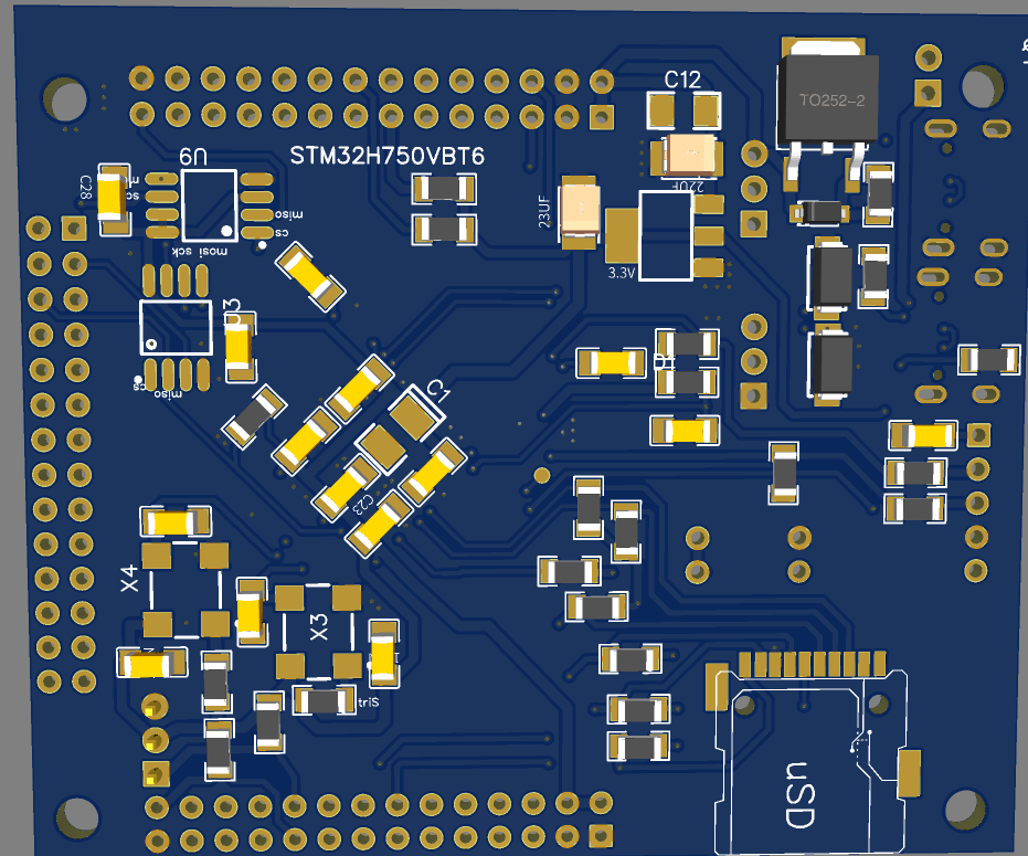

Thank a lot for this post because i have made my pcb too base on stm32h750 the mcu is very hot at 480mhz i am going to try to reduce speed to see if any changes.. i was thinking about my design because i have put all the capacitors like intel processor on bottom layer pcb to have them close has possible from their respetive pin.
The power supply is ams1117 and its working good that deliver 3.29 volt dc and its not hot.
2024-08-05 2:57 PM
What kind of hot? Uncomfortable or burns to your finger hot?
The latter indicates something seriously wrong, and a conduction path you don't want. ie Internal LDO outputting 1.25V into 3.3V supply rails.
The AMS1117 can push an AMP. Might suggest you check how much your circuit is drawing vs reasonable expectations.
2024-08-06 2:25 AM
Thanks DeLorean
Here is my pcb design
It's my first stm32 pcb sure that it's not perfect because i am learning i am comming from esp32 world that is really more simple.
I have faced some problems with clock ic at the begining because i have buy by mistake 3 states clock(with no data sheet Aliexpress is not perfect.but it's affordable..) and not crystal. (but achieve to make it work).
- QSPI and Spi flash are working perfect i have follow Controltech tuto on youtube and all result was good.
- what value of resistor do you recommand for input pullup on stm32h750 pins ?
