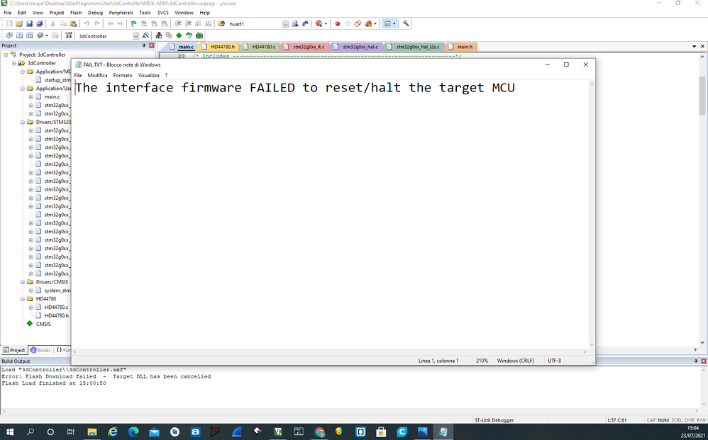

Hi there!
i buy a STM32G031 Discovery Kit, i try to program with Keil uVison but gave me this error "No target connected" , i download the last version USB driver for STLINK but i have the same problem. Some one can help me ?
Thank you

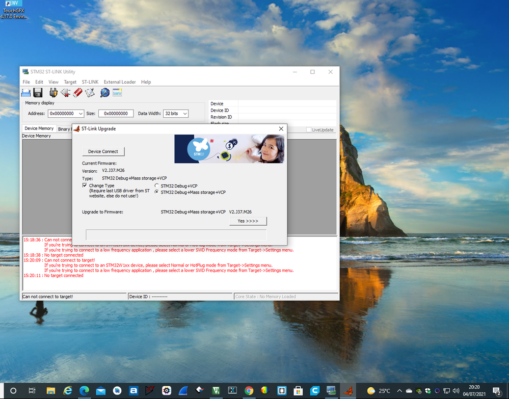

i just realize i didi this mistake i check change Type , how can i fixed ?
Thank you
Sergio

Hello @SGian.1​ ,
It's recommended to use STM32CubeProgrammer (STM32CubeProg) which is an all-in-one multi-OS software tool for programming STM32 products.
Please try this and keep me informed about your update.
Imen

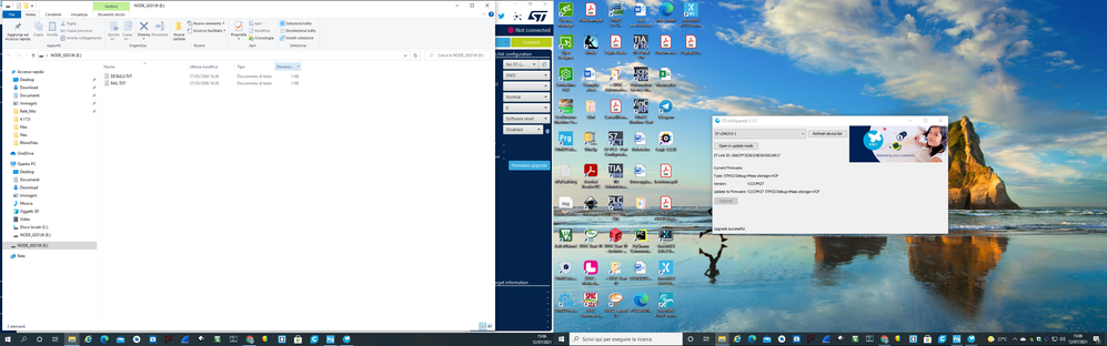

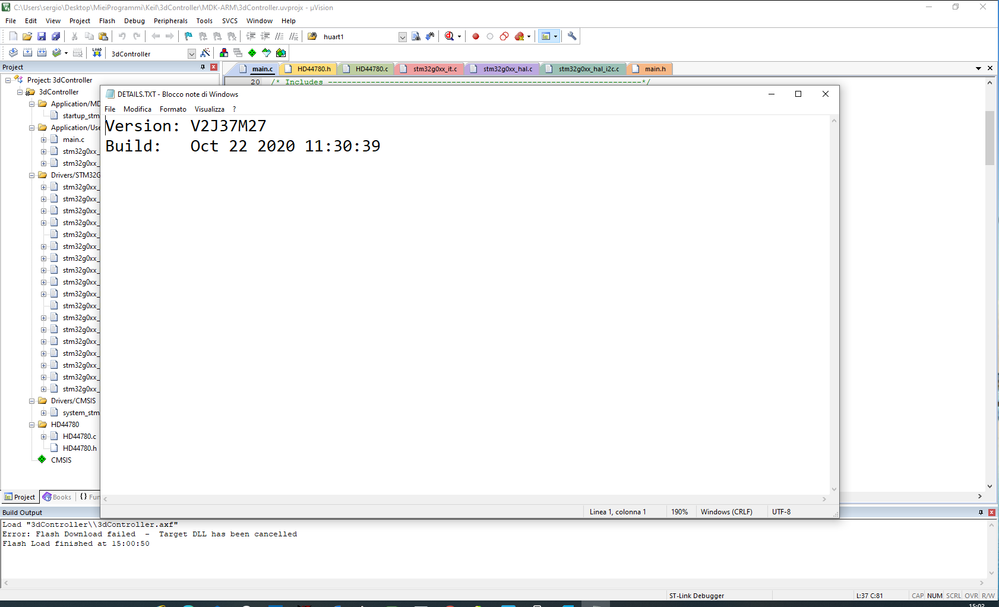

thanks for yor answert. I try but still dosen't work that is what happend after i download the new firmware. I know the mistake happend because i check change type combo 0693W00000BdRVIQA3.png

Hi @SGian.1​ ,
Try to put Boot0 pin in VDD (high).
After that, turn power OFF then ON.
Please keep me informed about your update on this issue.

sorry for the laste answert but i was in holiday. I just try but still dosen't work
