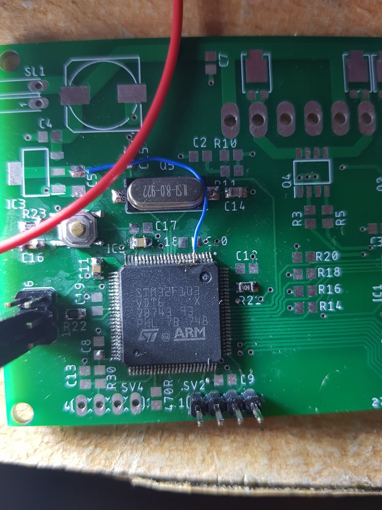

Hello!
I have designed a custom board, i have attached the schematic of it. My problem is that I have an ST-link v2 and i cant connect to it, i get target not found. Is my schematic correct or I have missed something? I have power and ground on all necessary pins on my board. I connected VDD, GND, SWDIO and SWCLK to my board from the ST-link, I used pins 1, 7, 9, 20. I tried to swap the pins of the data and clock signals, and all the settings in the ST-Link utility. My programmers firmware is up to date.

I think this is the case, I attach a picture. But I think that I confused it. I hate these on concrete situations, in the datasheet I have seen only one circle on the top of the IC. And on mine there are 2.0690X00000AqSorQAF.jpg
That chip is upside down.
With the text right side up, pin 1 is at the bottom left on the chip.
Agreed, it's confusing with two marks.
Thx, for the fast responses. I have any chance that my IC could work? It doesnt heated up or consumed high currents. Anyway I order some new pieces.
Based on my experience shorting stuff out and making hardware errors in general on stm32 chips, I would guess it still works. But it depends on what exactly it saw.
If it only saw 3.3v max at any pin, and the power supply was current limited, it’s probably fine for a benchtop test unit. Only one way to find out for sure though.
Orientation FTW, I just need to redeem my points
Yes, today I got it off and soldered in the right way. And I can communicate with it through SWD. Thanks for your answers! I test everything with current limit of 10mA, and this consumed under it with the wrong orientation too.
