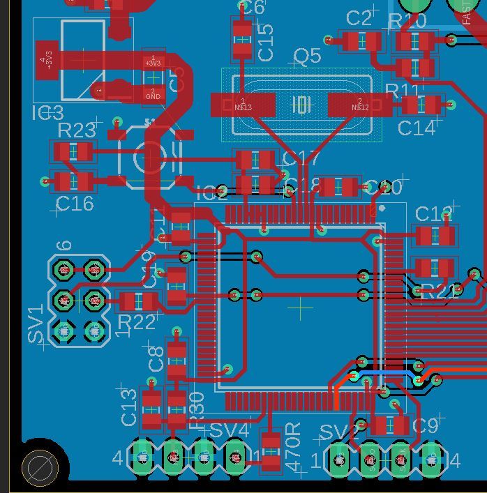

I have designed a custom board, i have attached the schematic of it. My problem is that I have an ST-link v2 and i cant connect to it, i get target not found. Is my schematic correct or I have missed something? I have power and ground on all necessary pins on my board. I connected VDD, GND, SWDIO and SWCLK to my board from the ST-link, I used pins 1, 7, 9, 20. I tried to swap the pins of the data and clock signals, and all the settings in the ST-Link utility. My programmers firmware is up to date.

That chip is upside down.
With the text right side up, pin 1 is at the bottom left on the chip.
Agreed, it's confusing with two marks.

Check the voltages
Check part orientation
Check level on NRST pin
With BOOT0 pulled high try talking to the ROM based System Loader, via USART1 PA9/PA10, at 9600 8E1 send an 0x7F data byte, and check for response. Use something like RealTerm which can send hex bytes.

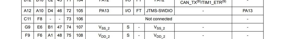

Is pin 73 really NC on the package? Seems odd.

I tried that too, with no luck. If Im correct it is NC, I attach the datasheet.0690X00000AqRyHQAV.jpg

Definately sounds like you've got the device rotated.
NRST will be low absent a VDDA supply on the correct pin.
Show clear, in focus, high resolution photo of the chip on the board.
Don't confuse the mold ejector marks for pin 1 designation

I think this is the case, I attach a picture. But I think that I confused it. I hate these on concrete situations, in the datasheet I have seen only one circle on the top of the IC. And on mine there are 2.0690X00000AqSorQAF.jpg

Did you measure *directly* on the pins? I am aiming at bad solder joints.
Did you measure also VDDA/VSSA?
Is the text on the chip bottom-up?

Yeah. I have thinked about this, and I measured all the voltages on the top of the pins, near the package with really thin probes. I measured all of the vdd/vss pins. No, the text is up-buttom.
