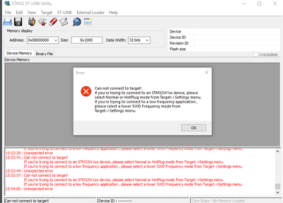

I use STM32 ST-LINK Utility   to do NUCLEO‑H503RB programming bin file, and the result is that I can’t connect. How to solve it?

Try the latest STM32 CubeProgrammer.

This utility is unfortunately no longer developed, it does not know new chips such as H5.
How to solve it?
Use recommended and supported tools from ST and other vendors (J-Link for one).

Have any other STM tool to support NUCLEO‑H503RB?  The NUCLEO‑H503RB board is type C connect, so I can't  use J-LINK connected.
Pavel A.
STM32 CubeProgrammer. IS WORK  thanks
