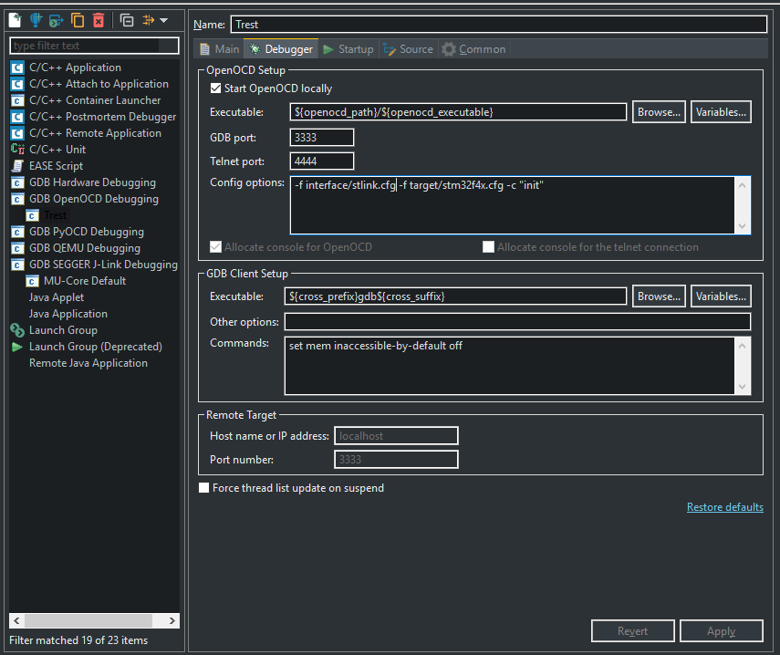

Hello.
I bought this programmer: ST-LINK V3. I need it to debug my program in eclipse. I tried everything but the programmer doesn't work.
Does anyone have a tutorial to debug with this programmer?
programmer working with this appplication: STM32CubeProgrammer
So problem is in eclipse and his settings.

Here is funcion solution.... for STM32F427 and SWD programming.
-f interface/stlink.cfg -f target/stm32f4x.cfg -c "init"
Thank you for this! :)
