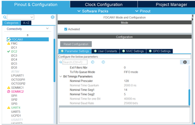

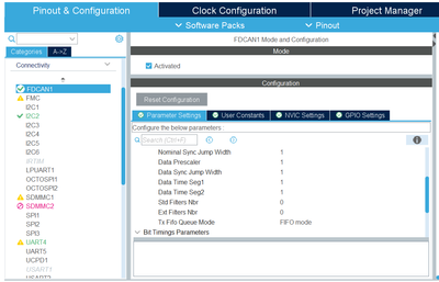

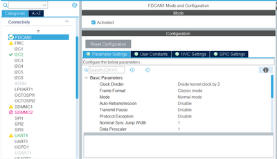

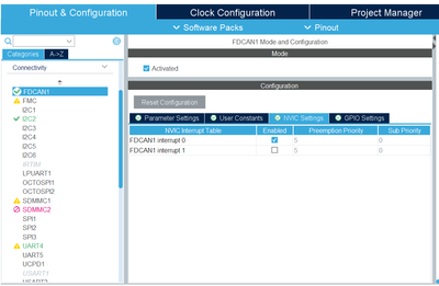

I Have developed a code to send and receive CAN messages using STM32U5A5 nucleo board. I am able to send and receive CAN messages however when receiving FDCAN interrupt is not always triggered leading to message loss. The behavior is random. I am using FreeRTOS to send the received messages to task using queue and re-transmit the same message.
The HAL software pack I am using for U5 is 1.6.0.
Following is the relevant code snippet. And attached is the .ioc snippet.

    /// Enable the Rx FIFO 0 interrupt
    if (HAL_FDCAN_ActivateNotification(&hfdcan1, FDCAN_IT_RX_FIFO0_NEW_MESSAGE, 0) != HAL_OK)
        printf("Failed to activate CAN notification \r\n");
        Error_Handler();
