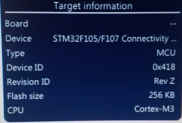

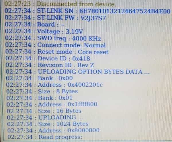

‎2020-10-01 4:33 PM
You were right, after I connected VDDA to VDD it worked (and without a 10uf capacitor but I will definitely install it in further development).
Thanks again a lot and sorry for my behavior.
‎2020-10-01 4:37 PM
The problem is solved!
The downside was that I didn’t connect VDDA to VDD because I felt it wasn’t necessary if I didn’t use ADC.
after I connected VDDA to VDD it worked.

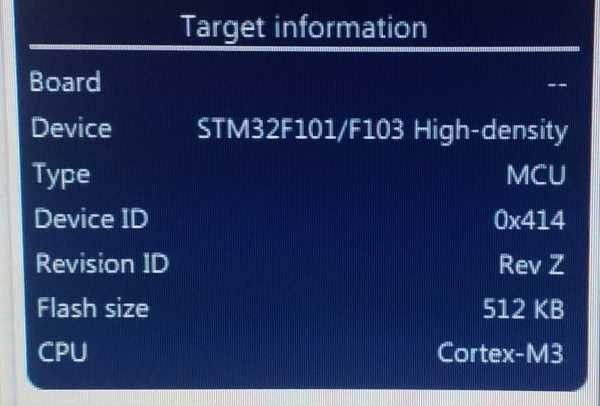

Even weirder but positive experience, the second board in the picture with STM32F103ZET6 has only one capacitor between pins 144 and 143 and of course connected VDDA to VDD and works as well.
So as I assumed and tried to tell you, capacitors are not too necessary for the controller to simply try to connect to stlink as I wanted and considered that capacitors are not a problem as it turned out but unconnected VDDA to VDD in my case.
