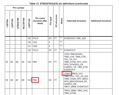

I connected it like this:
JTAG               NUCLEO
TCK     =>        SWCLK-JTCK (PA14)
TMS     =>        SWDIO-JTMS (PA13)
TDI       =>        JTDI (PA15)
TDO     =>        JTDO (PB3)
TRST   =>        NRST
GND     =>        GND
3.3V      =>        VDD_Target
