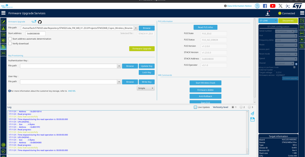

I wanted to develop BLE application using the nucleo stm32wb55rg and the zephyr project v4.3.0. what i did is take a nucleo stm32wb55rg board first i upgraded the FUS from the STM32Cube/Repository/STM32Cube_FW_WB_V1.23.0/Projects/STM32WB_Copro_Wireless_Binaries/STM32WB5x/stm32wb5x_FUS_fw_1_2_0.bin
then after this i updated the wireless stack firmware with this one STM32Cube/Repository/STM32Cube_FW_WB_V1.23.0/Projects/STM32WB_Copro_Wireless_Binaries/STM32WB5x/stm32wb5x_BLE_HCILayer_extended_fw.bin.
after this i power cycle the board, which is required for the wireless stack to load.
after that i build a sample from the zephyr v4.3.0 buluetooth samples "Peripheral_dis sample"
i build it for the nucleo_wb55rg board and flash it, the flash logs can be seen below.
after this i connected a serial terminal to view the logs and the logs can be seen below. the zephyr is unable to communicate with the wireless stack with error timeout.
i have tested this setup with multiple wireless stack binaries such is from 1.13.0 and 1.17.0 and 1.19.0 wireless binaries but all resulted in the same error.
what i want is an guide to get started with, or may be look at my current flow and tell me where am i going wrong.
looking forward to hear from you.
thanks and regards
Akbar Shah
