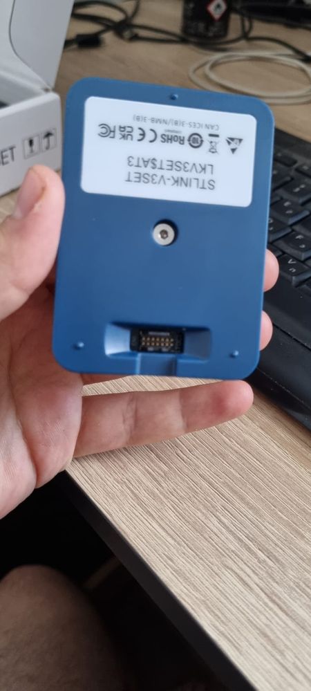

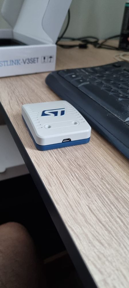

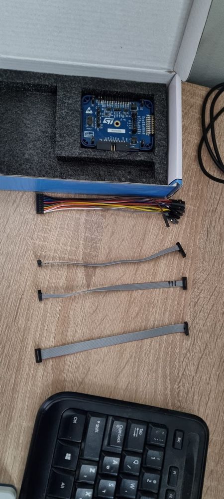

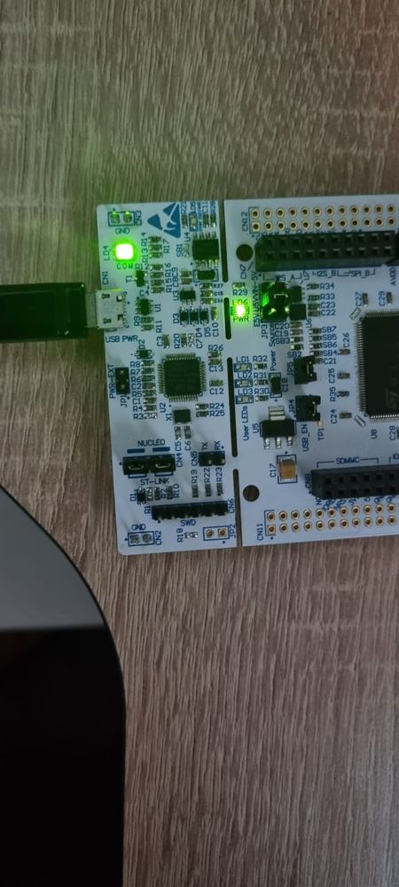

Hello there.
I'm a beginner with MCU programming and hardware, in order to get into the field I purchased a board suggested by someone in another forum, then realizing that the debugger is another hardware unit I purchased it aswell.

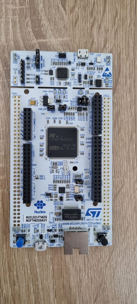

I managed to connect the flat cables found in the STLink box to the STLink and the STLink to the PC via USB however I can't find any pins to connect the STLink to the MCU.
I would like to know if I missed something or wasted some money in purchasing incompatible components.
Thank you.
I will have pictures attachedWhatsApp Image 2024-06-01 at 11.55.26 (1).jpegWhatsApp Image 2024-06-01 at 11.55.26.jpegWhatsApp Image 2024-06-01 at 11.55.27 (1).jpegWhatsApp Image 2024-06-01 at 11.55.27 (2).jpegWhatsApp Image 2024-06-01 at 11.55.27 (3).jpegWhatsApp Image 2024-06-01 at 11.55.27.jpegWhatsApp Image 2024-06-01 at 11.55.28 (1).jpegWhatsApp Image 2024-06-01 at 11.55.28.jpeg

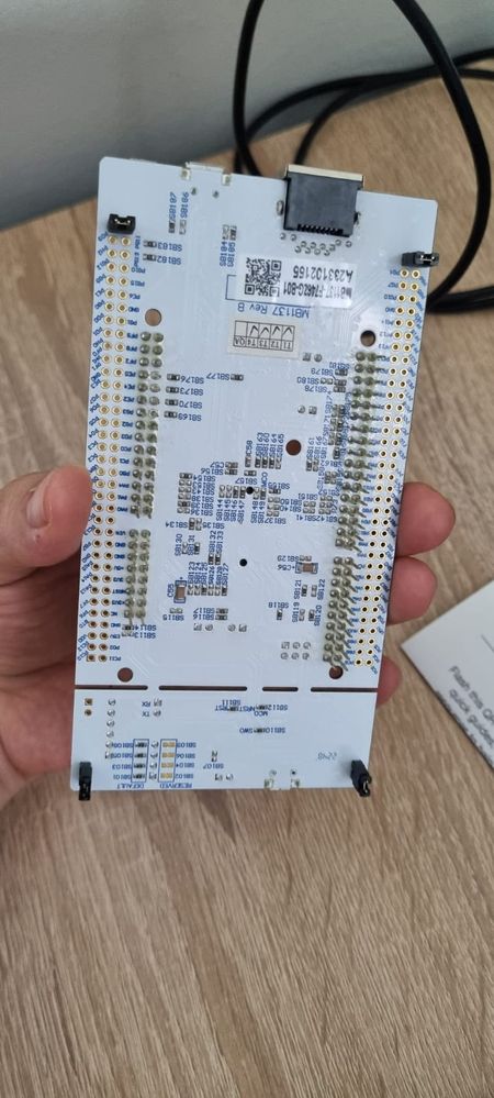

The Green Box shows the ST-LINK USB connection
The Red Box shows the jumpers connecting the Target SWDIO/SWCLK pins to the On-Board ST-LINK
The schematic can be found on the NUCLEO-F746ZG product page under the "CAD Resources" tab

Hello @Sagiv_Alia
I suggest you to take a look at the UM2448. That should be helpful for your case.
PS: the Nucleo-F746ZG already integrate an ST-link, no need to use an external one.
Best Regards.

Hello @Sagiv_Alia
You have to follow the UM1947 for more details on how to do it.
Best Regards.

The Nucleo has an on-board debugger, no need to connect the other debugger. Pluf USB on the side with the F103. You should be able to start the stm programmer or debug server.
Use the USB connection on the NORTH/TOP END of the board. Use a Data Cable, not a charging cable.
Can access via STM32 Cube Programmer, or CubeIDE

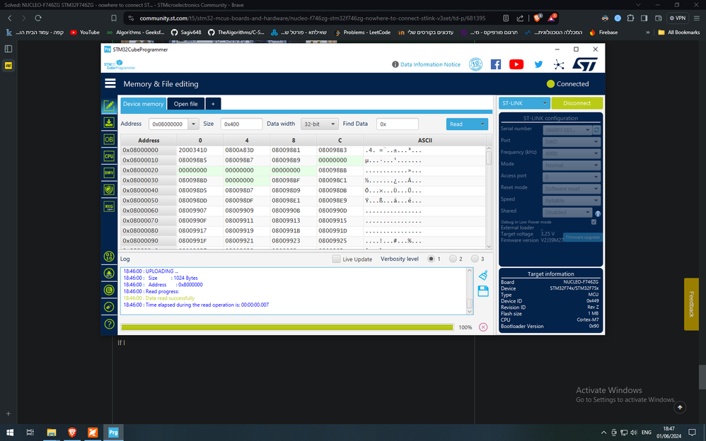

Sagiv_Alia
Is that the ideal result? WhatsApp Image 2024-06-01 at 18.48.19.jpegScreenshot (1).png
