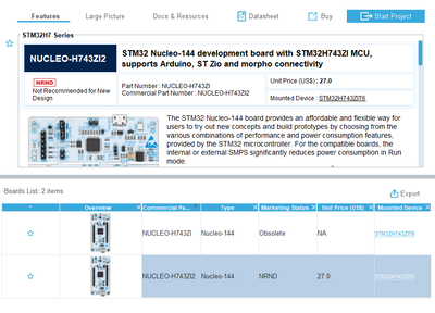

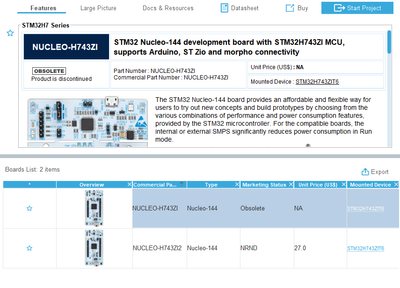

Is the NUCLEO-H743ZI2 (MB1364B, ST-LINK/V3) really NRND? I see the NUCLEO-H743ZI (MB1137, ST-LINK/V2-1) one is, and that's not surprising, but the ZI2 doesn't have it's own landing page  https://www.st.com/en/evaluation-tools/nucleo-h743zi.html
As I recall the STM32H753ZI is based on the ZI2 (MB1364B) board, so there's going to be a handful of different pins related to LEDs and QSPI, as I recall.  https://www.st.com/en/evaluation-tools/nucleo-h753zi.html

Hello @Tesla DeLorean
The NUCLEO-H743ZI2 is an NRND product:
The NUCLEO-H743ZI is an Obsolete product:
Best Regards.
