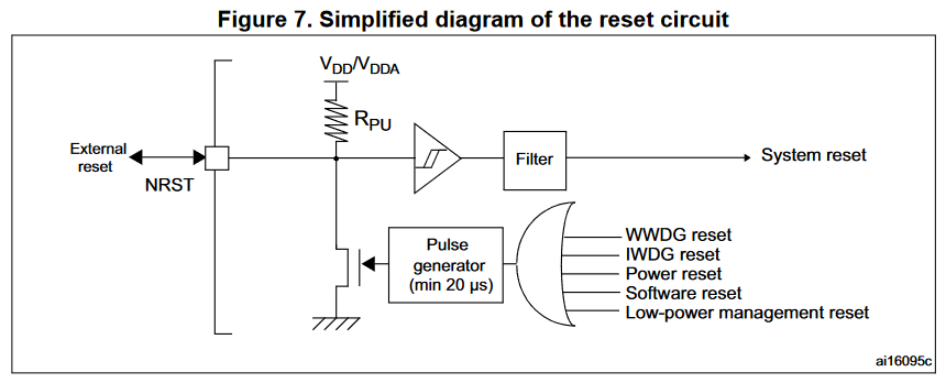

First of all, NRST does not need a pull-up resistor, as was common with MCUs of the last century, because there is already a pull-up in the STM32. However, a capacitor of 10...100nF should be connected to NRST against GND.
Furthermore, NRST acts not only as an input, but also as an output. It can put several internal reset sources as a pulse of about 20µs to the outside circuitry, as you can find in RM0008 under Power Reset. For example, you may have activated the watchdog WWDF or IWDG, which triggers a reset if the watchdog has not been triggered before.

@Peter BENSCH​ , I agree. In one of my trials, I completely removed 10k resistor and put 100nF. But still it behaved same. I have gone through RM0008 document, and the following scheamtic. It is less likely that any of this happening as I have used brand-new controller on a fresh pcb and didn't een flash any code. From your reply can I assume there's no issue with my schematic? (i mean from VDD, VSS connections point of view). If this still happening.. there might be some issue with PCB itself and may be I can safely go for another PCB manufacturer...

I don't see any serious problems in your schematics. You will only not be able to start the internal bootloader because BOOT0 is fixed at GND, but with e.g.R16=100k and BOOT0 = 1 at reset, this would be possible.
The IWDG and WWDG are disabled after reset if the option bytes (see PM0075, section 2.5) have not been changed (they contain 00FF5AA5 00FF00FF 00FF00FF 00FF00FF when fresh). The other reset sources should also behave quietly when unprogrammed.
If it's not your other environment that's haunting the circuit (interference pulses, other couplings, etc.), I suspect that it's not so much a problem with the board, but rather with the STM32103 - at the moment you can find a lot of offers with fakes because of the extremely tight supply situation. Are you 100% sure that they are not fakes/counterfeits?
