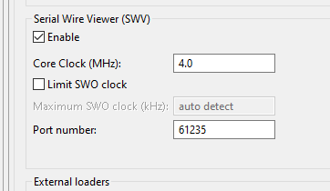

New question: the ITM SWO printF-ing works with frequency of 4 MHz. I have searched every little PDF regarding my board (NUCLEO-U575ZI-Q) and i have no clue where you can find this number. Can anyone help me? The frequency in question is this one:

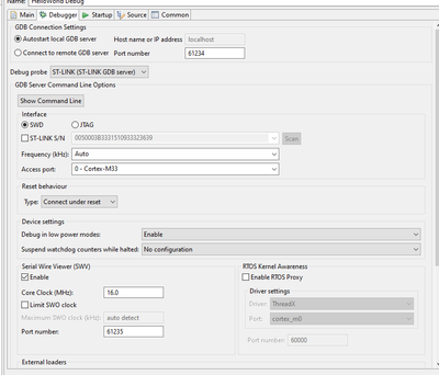

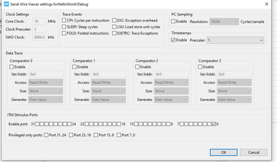

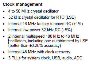

3. You have to have your CoreClock config synchronized: The only thing i found is in this image. I used both 16Mhz and 48 mhz, with no luck
Now, my config looks like this:
With ITM config like this:

https://www.st.com/resource/en/datasheet/stm32u575zi.pdf
"The system clock after wake-up is MSI up to 4 MHz"
So if your code does nothing, and doesn't bring up the HSI, HSE or PLL's, it will be running at 4 MHz

Gentlemen, i have now figured out that the frequency was 4 MHz. It works with that.
Now let me reiterate the question. Can anyone find where the 4 MHz comes from (i got this number by bruteforcing it and trying it randomly).

Usually this number must match the value of global variable SystemCoreClock.  For 4.0 MHz SystemCoreClock must be 4000000.
SystemCoreClock will change after your code calls SystemClockConfig() so you want to call SystemClockConfig early, before any printf, and put in the SWV settings box the value after this call.

System should be able to back compute by picking through PLL settings, clock source, and things like HSE_VALUE for board level specifics.
