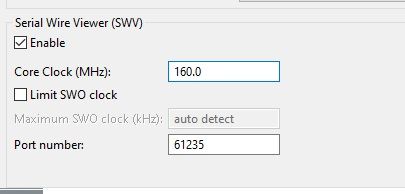

  • In STM32CubeIDE debug configuration, make sure to enable the Serial Wire Viewer and to configure the proper core clock (if using STM32CubeMX, check the Clock configuration tab). In my case the core clock is 160 MHz0693W00000NsdHpQAJ.jpg

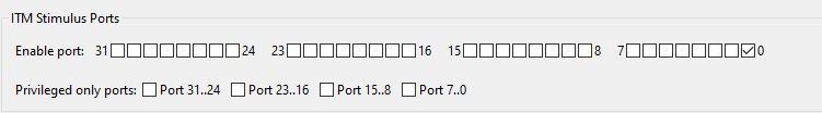

  • In debug mode, enable the SWV ITM Data Console and click on the configure trace 0693W00000NsdKKQAZ.jpgIn this configuration window, check that the Port 0 is enabled:0693W00000NsdKoQAJ.jpg
