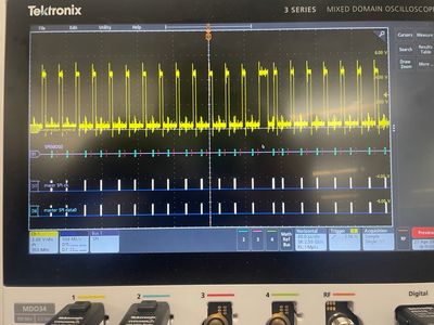

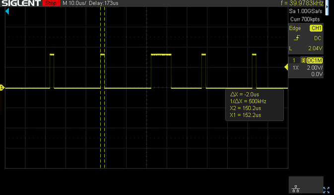

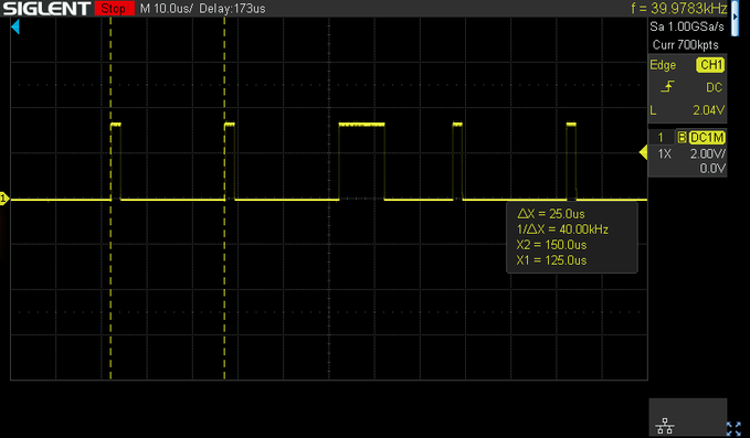

I want to generate a timeslot control signal consisting of one 10-microsecond pulse followed by fifteen 2-microsecond pulses.
I want the period to remain constant, aligned on the falling edge.
My problem is that before and after the long pulse, the period changes, and I don’t know how to fix it.
I have:
instead of:
I use two methods and i am not able to make both of them work.
Here is my code:
Method 1 : Timer1 16 in PWM mode

for the second method i have an extra problem, i can not have a pulse with less then 3 micro second width
Can somebody help me please?

You want the Period to be the same, but don't state WHAT it is.
Perhaps you can use PMW Mode 2, and modulate the width of the LOW portion?
Other alternative for patterns are TIM+DMA+GPIO->BSRR

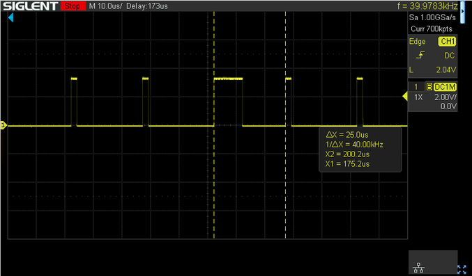

i want a period of 25 microsecond.
If i modulate the low portion, all my pulses would have the same width and i do not want that to happen.
Would they?
If the period is fixed, and you modulate the low portion, then that means the high portion has to change - ie, your pulse widths do change!
QEF ?
Set up the channel to toggle on match, leave the pulse value at 0 and set up the ARR field to be the duration of the high time, low time, high time, low time, etc...
{10, 25, 2, 25, 2, 25, ...}
It shouldn't be hard to maintain the period, if you change the duty of the space, the mark is tied to it,  no?
As TDK mentions Toggle Mode would also work, you'd need to ensure the polarity

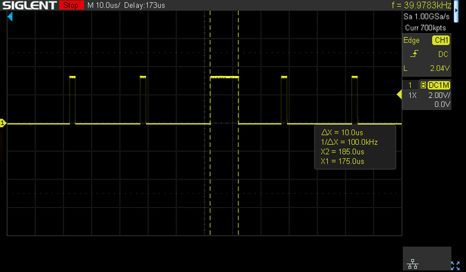

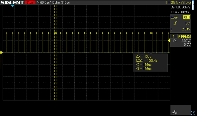

I just use the HAL_TIM_PWM_ConfigChannel to change the pulse
15 pulses at 2us and 1 pulse at 10us
period is 25us
10us long pulse
2us short pulses
TIM_OC_InitTypeDef sConfigOC = {0};
void InitTim15(void)
	sConfigOC.OCMode = TIM_OCMODE_PWM1;
	sConfigOC.Pulse = 33;
	sConfigOC.OCPolarity = TIM_OCPOLARITY_HIGH;
	sConfigOC.OCNPolarity = TIM_OCNPOLARITY_HIGH;
	sConfigOC.OCFastMode = TIM_OCFAST_DISABLE;
	sConfigOC.OCIdleState = TIM_OCIDLESTATE_RESET;
	sConfigOC.OCNIdleState = TIM_OCNIDLESTATE_RESET;
volatile uint32_t pulseCount = 0;
void HAL_TIM_PWM_PulseFinishedCallback(TIM_HandleTypeDef *htim)
	if(pulseCount == 15)
		sConfigOC.Pulse = 160;
		if (HAL_TIM_PWM_ConfigChannel(&htim15, &sConfigOC, TIM_CHANNEL_2) != HAL_OK)
			Error_Handler();
	else if(pulseCount == 16)
		pulseCount = 0; // reset
			Error_Handler();
	++pulseCount;

Oh, after a second read, you do want the period to be constant. Just invert the polarity of the channel from what you're already doing. You'll need to specify the negative duration instead of the positive duration, but then the period will line up with the falling edge instead of the rising.
Another option would be to use downcounting instead of upcounting.
it does work thank very much, i was loosing my mind trying to do this.
