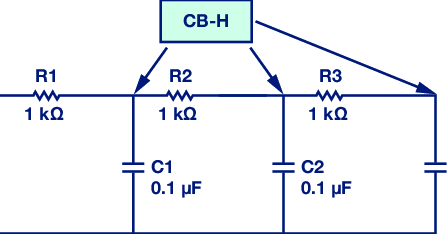

An RC filter close to the MCU pin can get rid of spikes. If you only care about 40 Hz, maybe a 1kHz filter (0.1uF, 1kOhm).

Some days ago, I thought about using a third-order passive RC low-pass filter like this one:
I didn't think that a simple RC filter could be effective enough.
I will try. Do not hesitate if you have any other ideas.

It really depends on the nature of the noise. But just guessing, I would think most spikes are much shorter than 1ms in duration and that filter should perform great, as long as you can live with the small time delay. The filter will be more effective if it's right next to the chip, as the long leads act as antennas. Since you're using a board, it will be less effective when placed at the pin header but I would still expect it to solve the problem.
Since you are able to measure the spikes, it may make sense to measure exactly what the mcu currently sees and use that to guide your choice of filters.

Signal integrity 101: in 3D minimize the ground and adc signal formed loop to reduce its inductance. You may also try to make twisted cable like lvds signal, and run your cable orthogonal to coupling noise generator, or shield the cable on both end. Then use adc to hw average if the function is available.
LCE
Principal II
As said above: filtering, but also grounding and signal flow. No loops!
Mind that the STM32 ADCs don't have very high input impedance, so you might need a buffer after the filter. I recommend that anyway when using a sensor, also for protection of the STM32 input. So build a 3.3V-single-supply non-inverting opamp buffer.
Maybe you might need a difference amplifier at the input with at least some common mode rejection.
Is the STM-board inside a (grounded) case?
Maybe there's coming some more EMI from other sources, not only the sensor input.

https://en.wikipedia.org/wiki/Operational_amplifier_applications#Non-inverting_amplifier
Connect voltage divider to input, remove R1, bridge R2, then connect RC low pass (with R = 1k, C = ? ) to output.
Supply opamp with 3.3V / GND.
Check that before connecting to STM32.
 And a properly grounded metal case might help, too.
Note: when refering to R1 / R2 I mean the opamp circuit shown on wikipedia, not the picture above...
