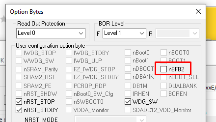

i am not able to run any code on bank2 with STM32L151RE with 512kB FLASH.

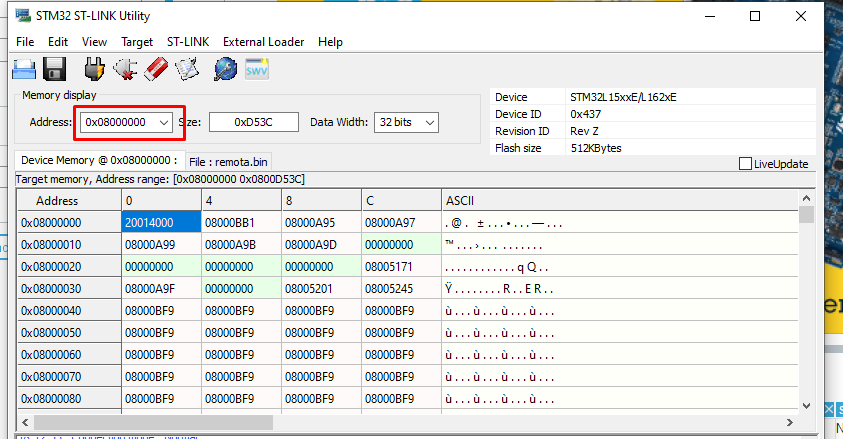

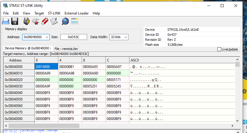

program was loaded on both regions 0x0800 0000 and 0x8004 0000
0693W00000HniqRQAR.png0693W00000HniqvQAB.png0693W00000HnirFQAR.pngif nBFB2 is checked the code runs ok, if i just unched the code does not run....
what am i doing wrong?

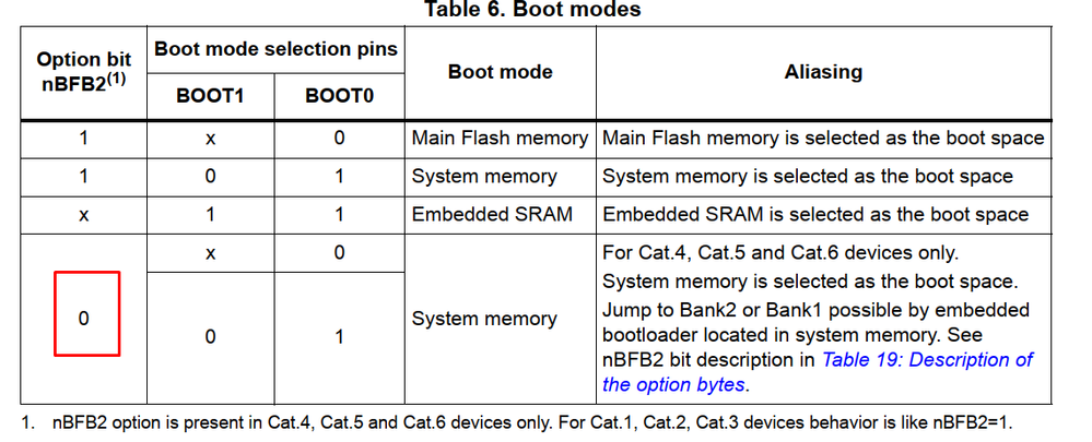

If nBFB2 is checked, the system boot mode is selected using the BOOT0 and BOOT1 pins on your device. What is the signal level on these pins?

BOOT0 is at GND, BOOT1 (PB2) is floating...
i am using a nucleo64 board MB1136, i replaced the original STM32L152RE with a STM32L151RE to ***** the dual boot, as i have verified the 152 does not have dual boot mode, is that right? or both of them work in dual boot mode?
but as i can see, if nBFB2 = 0 (unchecked), i.e. dual boot mode is active, the pins BOOT1 and BOOT0 does not matter, on booth cases the boot will be from "system memory", jumping to bank2 or bank1

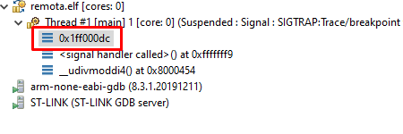

i am not able to debug when nBFB2 is unchecked
it seems to be locked in some region of the system memory
diegofontanabr
if i debug step-by-step (instruction by instruction) i can go very far away, but if i use the "step over" the process halt to that address

in AN2606, page 307 Figure 73. Bootloader selection for STM32L1xxxE devices, where it says "BFB2 = 0", its the same as "nBFB2 = checked" (it has a "n" in front) in the option bytes of the STM32 ST-LINK Utility?
i will always let the nBFB2 unchecked or checked?
i will change the value of the nBFB2 to choose bank1 or bank2 ? or i need to let it at always the same state and invalidate the first word at bank1 (0x0800 0000) or bank2 (0x0804 0000) to select wich firmware to run?
