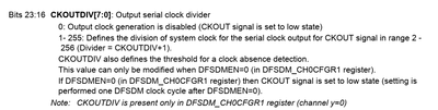

from rm :
So set ..try:
hdfsdm1_channel2.Instance->CHCFGR1 &= 0x7FFFFFFF ;  // dfs off
hdfsdm1_channel2.Instance->CHCFGR1 = (hdfsdm1_channel2.Instance->CHCFGR1 & 0xFF00FFFF)|0x00130000 ;
hdfsdm1_channel2.Instance->CHCFGR1 |= 0x80000000 ;  // dfs on

from rm :
So set ..try:
This works! Thanks for the pointer to the documentation.
I realized that the CKOUTDIV is present only in the register of channel 0. I always tried setting it in the register of channel 2.
After changing it it works. Thank you so much! Much appreciated.
