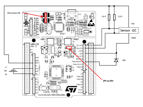

I prepared the circuit in the attached image and planned to remove the ST-Link part of the board to finish my project.  Before doing this (because I messed it up last time) I checked that I could externally power the board with a 9-volt battery. Before applying the voltage I disconnected from usb power and moved the JP6 jumper from  U5V to E5V. I plugged in the battery and everything worked fine.....but then I decided to change some code.

Out of the box JP1 was open.  I  hope to learn from this but I don't know where I went wrong.  I have another board on order and want to avoid this in the future.
I injected 9v to Vin and GND, the circuit worked until I  tried to go back to USB at JP5.
I couldn't derive from documentation how to separate the stlink, nor how to use it to program after it is removed.

Thank you hal. What other changes need to be made to the main nucleo board  before using it independently?  I changed power jumper JP5 to E5V, then powered the board with 9V from Vin and GND (see diagram).  Is this correct?
Posted on November 23, 2015 at 22:54
The manual does suggest that 9V should be viable in the configuration you suggest. I haven't had cause to break my Nucleo's apart or externally power them. Not really sure what would cause the part to indicate it is locked.
