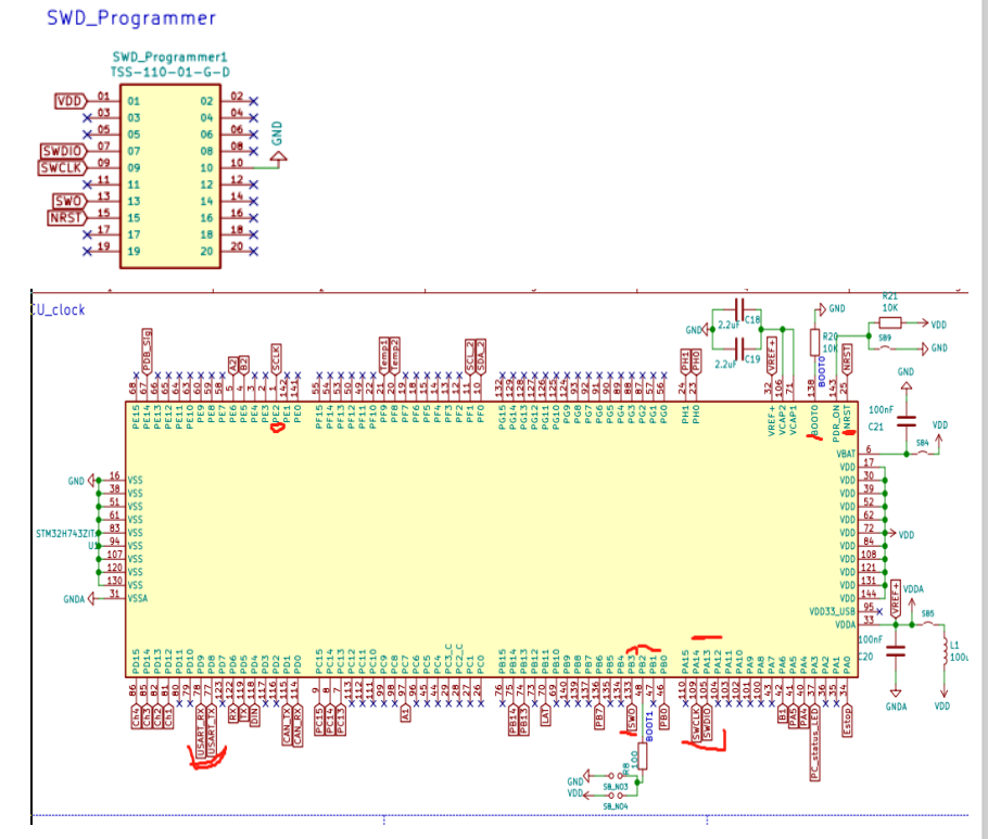

It should be capable of working and connecting. I'd have the NRST wired up also.
That you can't connect is more indicative that the H7 isn't running.
What other signs-of-life testing have you done? Can you pull BOOT0 High and connect to the ROM System Loader via USART1 (PA9,PA10) or USB?
Check level on NRST pin.
Check voltage on VCAP pins.

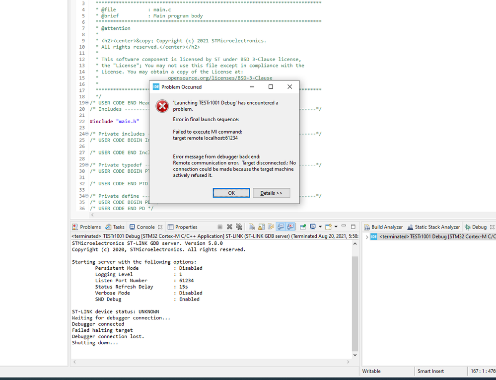

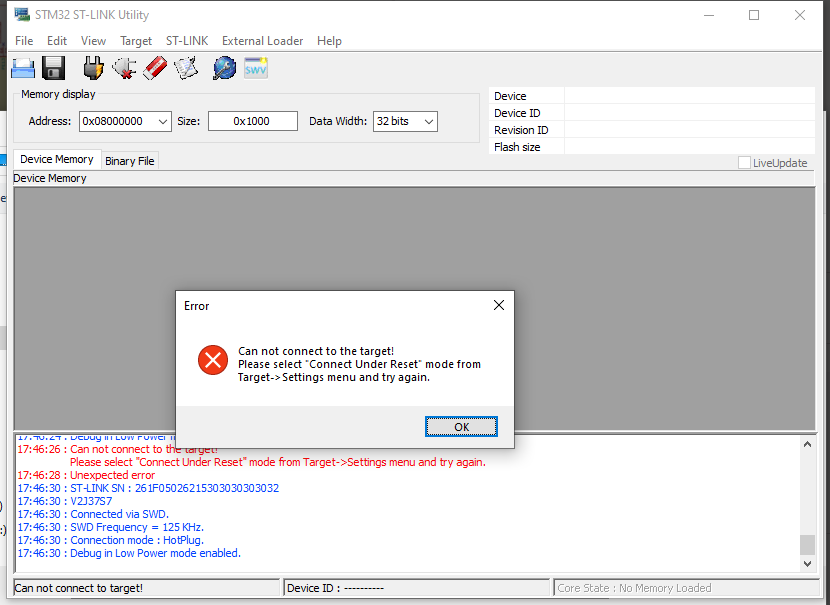

Update on the current issue (STM32H7 STlink-v2 programmer to breakout board ). it seems i can connect but the chip is not responding. here is the results from the STlink software tool. What am i missing ?
And the next is the results from the cubeIED
Hi @Community member​ thanks for your quick response, I forgot to mentioned that NRST PIN was connected. I have attached the schematics bellow. the only test I did was to check the VDD powering the board with 3.3V and i have tested the VCAP pins with 1V, as for the USART, only the USART3 pinout is available on this breakout board.
