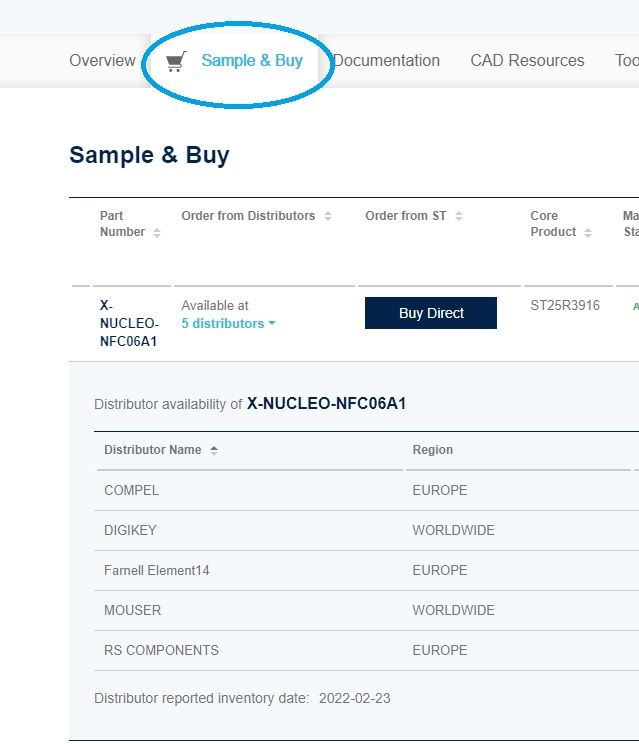

Hi Sai,
in addition to Peter answer, just click on "Sample and Buy" tab when browsing the webpage related to a given product on st.com. This tab displays the product availability at various Distributors:
0693W00000KaYjRQAV.jpgThe ST25R3916-DISCO seems to be temporarily out of stock at Distributors, so in the meanwhile, you can use the X-NUCLEO-NFC06A1 board (+ NUCLEO-64 MCU board)
rgds
BT
