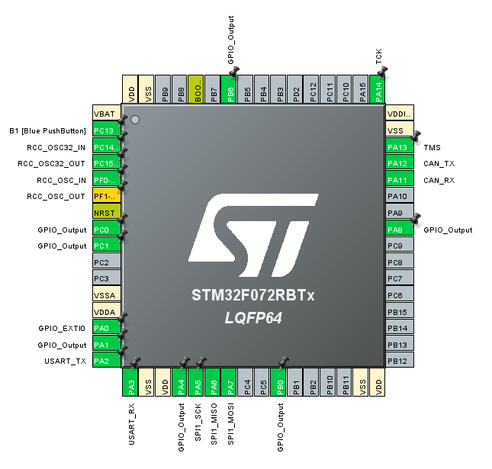

I am trying to port/get running the NFC08A1 RFAL polling demo on the NUCLEO-F072B.  I had no issues using L476RG.  I am fairly certain I have SPI set up correctly in CubeMX.
But, I am getting stuck at initialization, specifically at st25r3916CheckChipID().

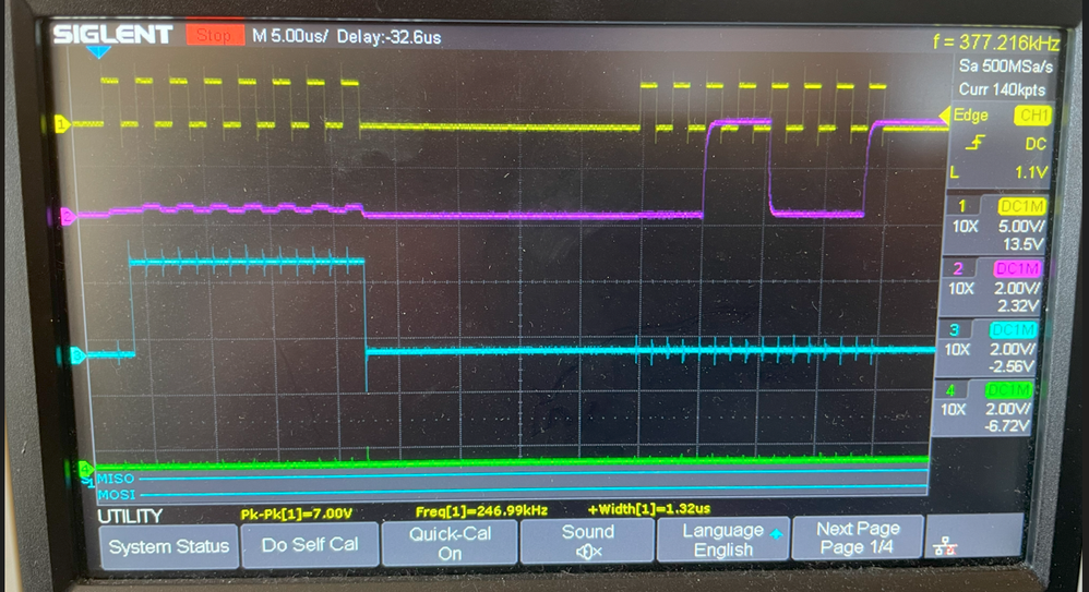

ID is read as 0x18, which is causing it to return false and throw an error.  I was taking a look at the SPI traces and MISO (pink) looks not quite as clean as MOSI (blue) (sorry, had to capture using phone camera):

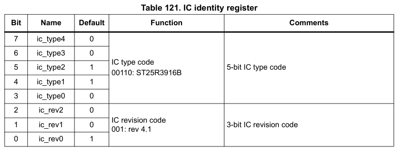

Rise/fall on MISO looks a little slow compared to MOSI.  Could this be causing the issue?  From the datasheet, it looks like chip ID should come back as 0x31:

On the scope you can read the 0x31 on falling slopes.
SPI  clock is set incorrectly, you need to put at "2 Edge" instead of "1 Edge".
