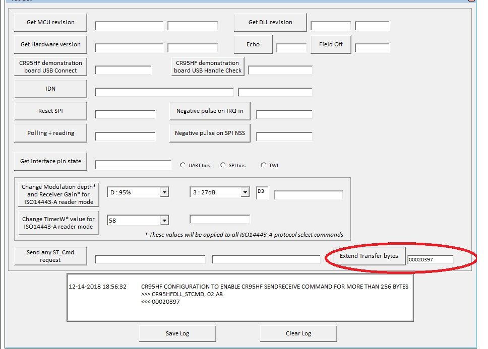

You can manually test the 02A8 command thanks to the CR95HF Development software application:
  • select CR95HF button in the "Please, select your RF transponder" window
  • in the Tools menu, select Tool box
  • click on Extend Transfer Bytes
You should then have the following log message:
12-14-2018 18:56:32	CR95HF CONFIGURATION TO ENABLE CR95HF SENDRECEIVE COMMAND FOR MORE THAN 256 BYTES
			>>> CR95HFDLL_STCMD, 02 A8
			<<< 00020397
The 00020397 reply appears in the text box close to the Extend Transfer Bytes button0690X000006CpuSQAS.jpg
If you don't need to sent frames bigger than 254 (ISO14443A) or 255 (other) to the tag, you don't need to use this patch.

Waller.George
Hi Brian,
When I press that 'Extend Transfer bytes' button, absolutely nothing happens. I can use all of the other features such as getting the IDN but when I try the 'Extend Transfer bytes' button nothing appears in the console log or in the text box immediately to the right of the button. I have noticed that my MCU FW revision is 3.6.0 when section 2.4.2 talks about 3.6.6 is there any way of updating this over the USB?

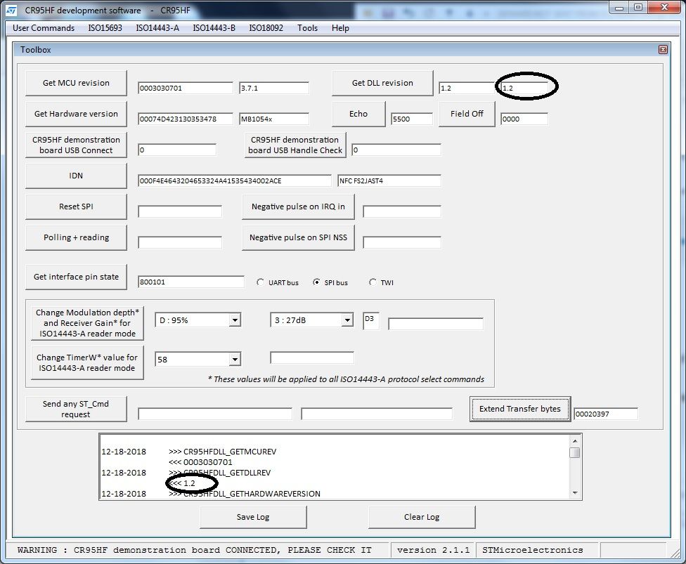

Waller.George
I have updated the MCU FW version to 3.7.1 however all of the bytes I send after the 56 bytes are random junk when read via the I2C from the FTM on the ST25DV. I'm using the DLL version 1.2 and can set lengths over 256 bytes (I know it's not necessary for this). Before I updated the MCU FW I could send a maximum of 56 bytes in the CR95HF_DEVELOPMENT_SOFTWARE, now I can send 256. This seems like quite a coincidence. Any pointers why this is the case?

Brian TIDAL
Hi Georges,
Would you please check the size of the buffers used in CR95HFDll_SendReceive(strRequest, strTagAnswer):
it must be
 char strRequest[1024];
char strTagAnswer[1024];
Let me know if this solves your issue.

Brian TIDAL
​Hi Georges,
the DLL is intended to be used with C and Visual Basic where the messages are sent as ASCII strings for convenience.
Would you please make sure that the string copied in strRequest[1024] is null-terminated? i.e. make sure to use strcpy, for example strcpy(strRequest,"260100") and not memcpy.
Can you check the DLL revision thanks to the Tool box menu  ?  The Revision should be 1.2.
Can you also check the MCU revision/HW version/IDN.
If this does not solve your issue, would you please share your piece of code when you use CR95HFDll_SendReceive()?
