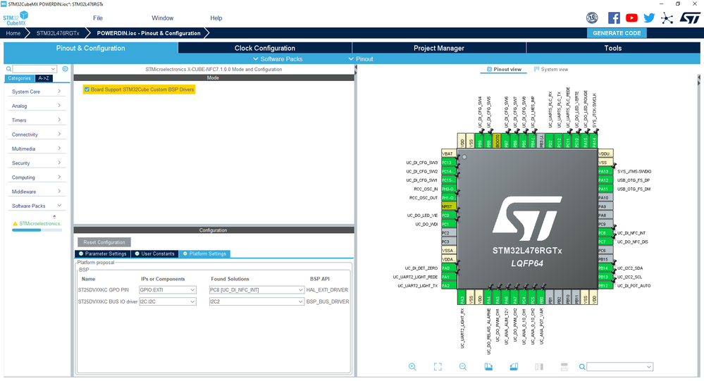

I have a custom STM32 board. I'd like to use ANT7-T-ST25DV64KC dev board to use NFC functionnalities.
I have red that I can use X-CUBE-NFC7 to communicate with this board.
In my cube MX, I have choose custom/NFCTAG7, I can configure IC2/GPO. Then, when I generate the code, I have an error. Compiler told me that "st25dvxxxkc.h" is not in the directory.
Is someone known where I can find this file ?

In STM32CubeMX, Pinout & configuration tab, software Packs/Select Components, make sure to select Board Part NFC7. I guess only Board Support STM32Cube_Custom_BSP_Driver has been selected (in that case a warning triangle is displayed to indicate a missing dependency and you can click on "resolve" to automatically add the missing components).
Let me know whether this solve your issue.

if I am not wrong, st25dvxxxk.c and .h should be in <yourProject>\Drivers\BSP\Components\st25dvxxkc folder (it should be automatically copied by STM32CubeMX from STM32Cube\Repository\Packs\STMicroelectronics\X-CUBE-NFC7\1.0.0\Drivers\BSP\Components\st25dvxxkc during project generation). Which version of STM32CubeMX do you use? Can you provide a screen shot of the X-CUBE-NFC7 mode/configuration in STM32CubeMX?

fab04
Thank you for your answer.
I used the version 6.6.1 of cube MX.
Brian TIDAL
Rgds
BT
fab04
Thank you very much for your answer, now I can compile (and there is no more warning triangle ;-)).
