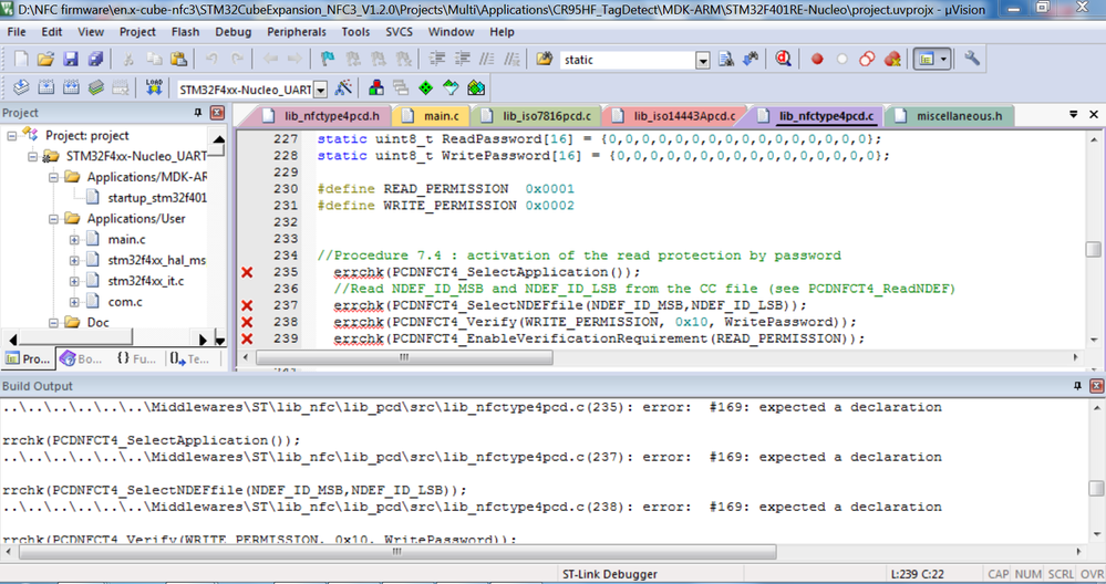

Now I'm trying to activate the read protection by password  as you mention  in line 227- 232 in lib_nfctype4pcd.c file but one error came during compilation 'error : &sharp169 expected declaration' ' error: expected identifier or '('.
How can I resolve this error?
Will I have to add these line in main() of main.c file or is there any other way ?

Hello
Thanks for support. But I already did these changes.
As you can see the error in caption below and I mentioned it previously .So I think these lines (lines below ''activation of the read protection by password'' for read protection) of code should be in some function.  help me out .
Posted on September 20, 2017 at 12:26
The commented code of lib_nfctype4pcd.c you are refering to was meant to be informative,
by showing a transcription of procedure 7.4 of the datasheet into the X-CUBE-NFC3 environment.
As you noticed it can not be compiled directly. You have to place it in some function
corresponding to the procedure, that you would call from your scenario.
For your information, the PCDNFCT4_ReadNDEF function from file lib_nfctype4pcd.c
corresponds to procedure 7.2 of the datasheet. You may implement in a similar fashion
a new PCDNFCT4_ProtectNDEF function corresponding to procedure 7.4.
Let me know it this clears things up.
