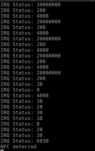

I am currently trying to port the ST25R3916B driver to a platform that uses the ThreadX RTOS, but I am encountering some issues. I have previously ported it to a platform using Zephyr, and that process went smoothly.
I have already implemented the platform-specific files responsible for I2C communication, IRQ handling, and software timers. The initialization process completes without any errors. However, in the main thread—where I call rfalWorker()—the NFC tag is not detected.

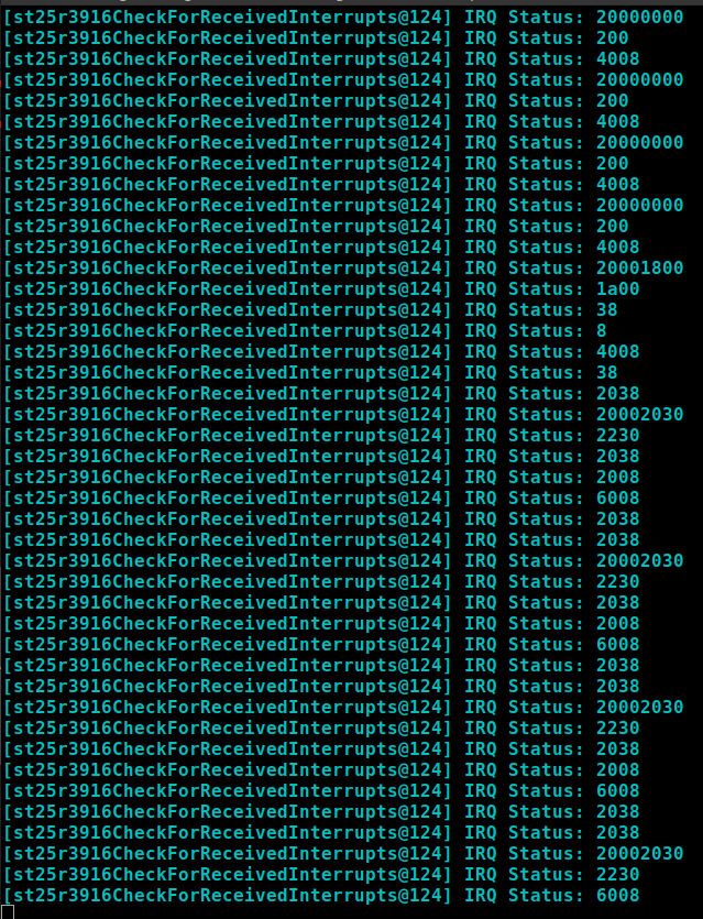

I printed the IRQ status values on both boards, and they are the same while RFAL is running in the idle state. However, when I tap the phone, the values become different.
I will attach screenshots of the logs (values shown in hexadecimal):
image.pngBbb
we don't have a guide on porting to ThreadX. What you describe sounds like it could be a concurrency problem: Main/task level and interrupt level both executing I2C and not being properly protected. Please review your platformProtect*() macro implementations.

Hi JPortilha,
hard to say what actually is happening. It looks like an NFC-A card being received and then some error happening during AntiCollision. The error is not signaled from the NFC chip. I recommend to attach a logic analyzer and trace SPI lines + IRQ. This will allow much more educated suggestions on the root cause.
BR, Ulysses
