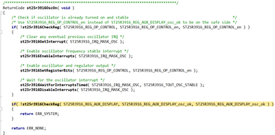

I've already replaced all the SPI functions from ST with the Nordic ones, and I've confirmed successful SPI communication using the SALEAE device. However, I'm encountering an issue with the MISO channel not receiving the correct parameters. As a result, the program initialization is failing in the line:

I believe the issue lies within the SPI configuration. While I am able to send and receive data, there are instances where the received data does not match the expected values by the ST25R3916B.

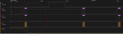

As you can see, the interruption gets triggered.
in this image, i'm asking for the CHIPID, and I receive 0x18 (that's the same with the NUCLEO L053).

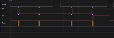

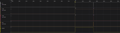

otherwise, here i should expect some data, and i do not get anything:
In addition, it's worth noting that the Chip Select (CS) pin only changes at the beginning and end of each transmission. This behavior is intentional because the ST25R3916B needs to keep the CS pin low while performing a multivalue send option.
