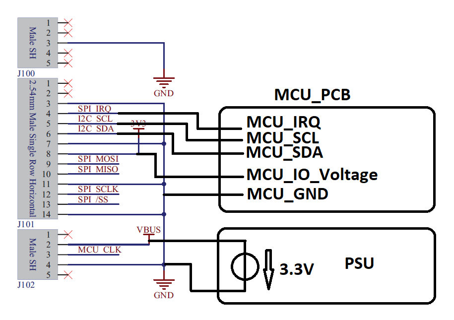

i have been trying to put the st25r3916 in wake-up mode but i detect high power consumptions (around 900 uA). I am using a very basic code just to test current consumtion, i2c communication seems to work, but maybe i am missing some parts.

Travis Palmer
1bit corresponds to 13.06mV. 100dec should be equivalent to 1,306V on the RFI pins, 171dec should be 2,23326V. In general these values are good.
Your i2c connection is not entirely clear to me. Below is a schematic of all necessary connections do drive the ST25R3916-DISCO MB1414-B with an external MCU PCB.
All these connections are mandatory for i2c.
Please let me know, if this solves your problem.
BR Travis
MPeli.1
Yes mine is the same, i just took the i2c and irq, pin 1-2-3 of cn100 connector as for page 26 of the user manual of the discovery board.
Vbus (pin 2 of the image that you linked) was disconnected, but since switch is on 3v3 position it should be ok right?
I tried connecting it to 3v3 but nothing changes.
Thank you very much,
Regards
Travis Palmer
At which Voltage is your MCU / MCU_IO running?
Is your MCU GND connected with the PSU GND?
Thanks, Travis
Hello Travis,
MCU is runnin at 3,3, and ground of mb1414-b and our MCU is shared and connected to the psu gnd, communications seems to work fine indeed.
Regards
