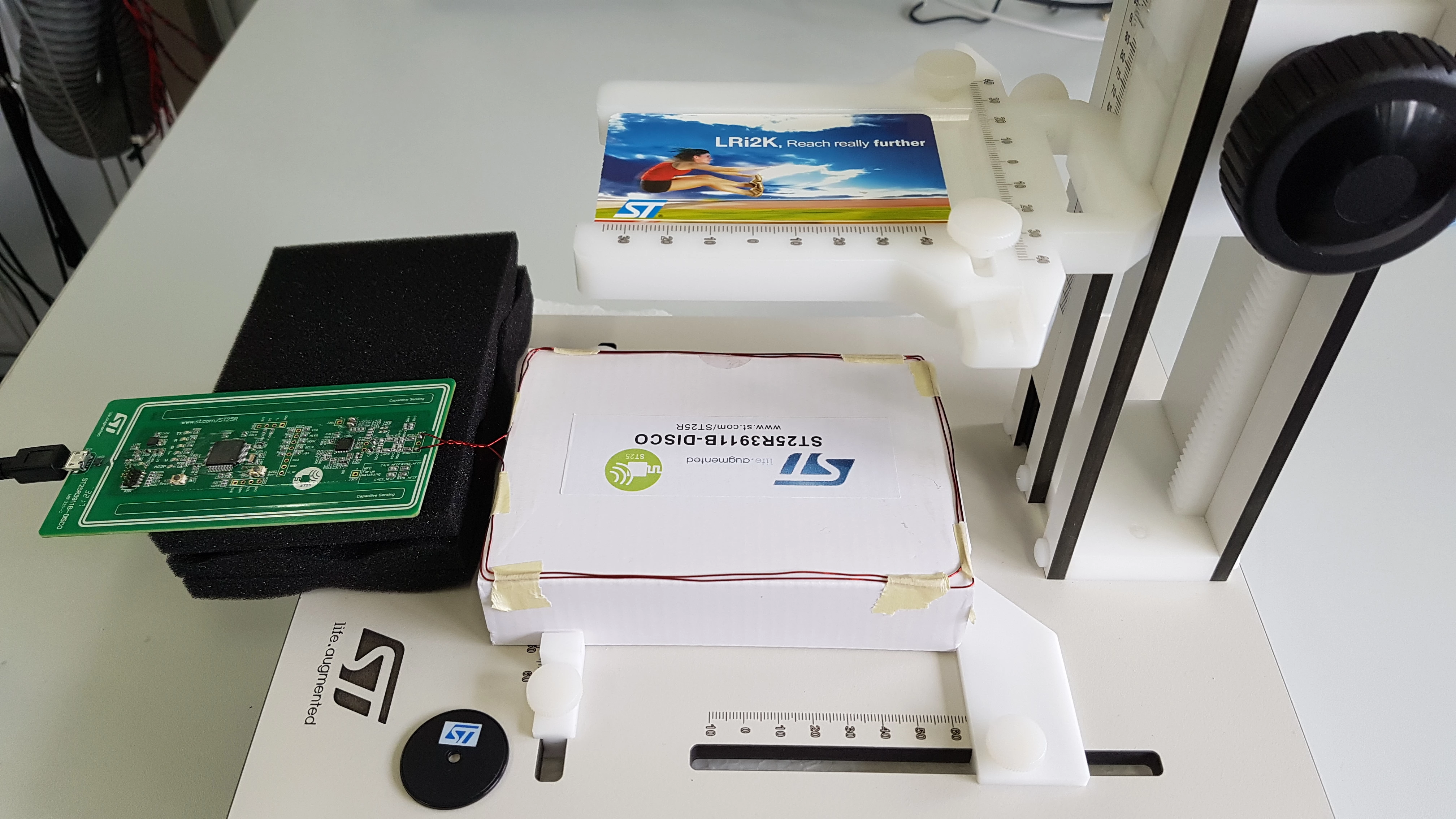

    I did a little proof of concept. I connected a 14x10cm 2 turn wire wound antenna to a ST25R3911B-DISCO board and measured the read range with several tags. The antenna inductance is around 1.7µH. The antenna has no middle GND connection.

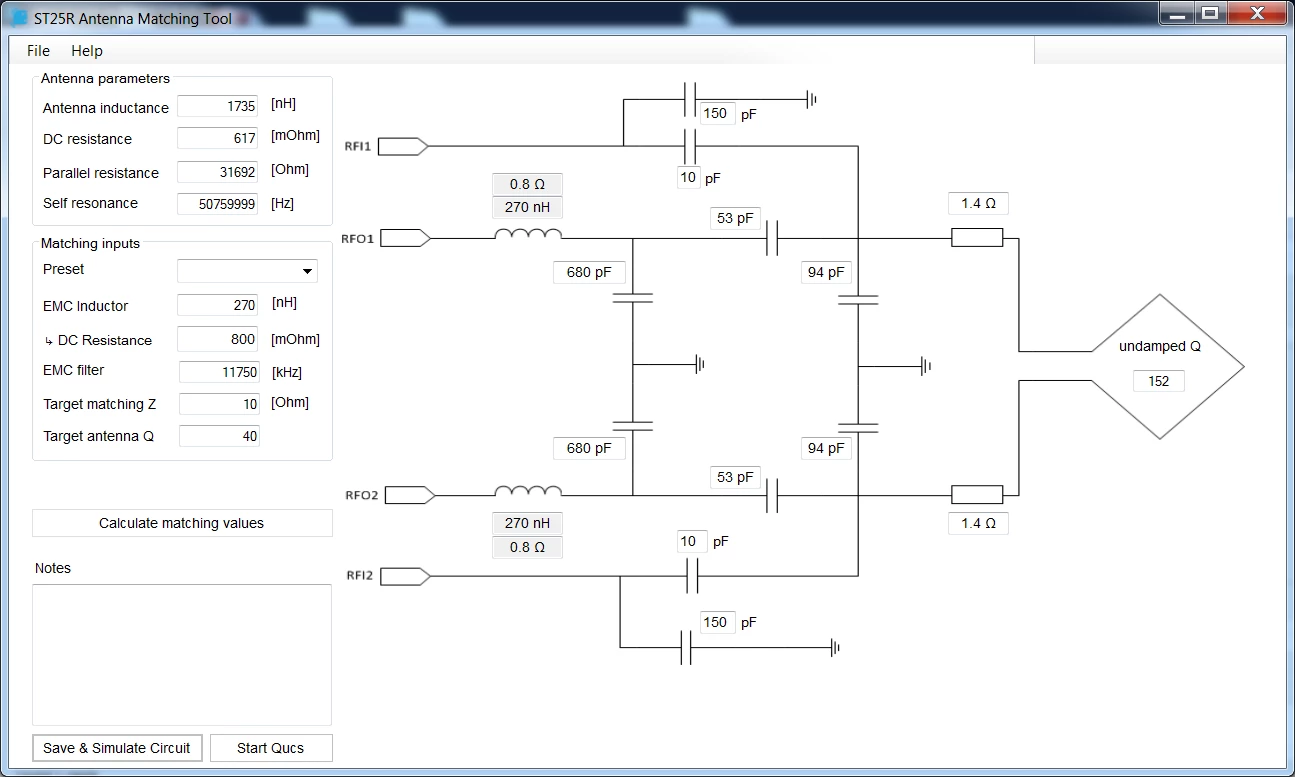

    Thisare the inputs i did in the ST25R Antenna Matching Tool:
    Besides the measured antenna parameters i have chosen my EMC filter settings and target matching impedance and target antenna Q.
    The presets define matching inputs for a special purpose. VHBR has data rates up to 6.5mbit and therefore requires very low Q-Factor. EMVCo only requires 106kbps therefore a Q-Factor around 25 is suite able. ISO15693 even has lower data rates. Therefore we can further increase the Q-Factor.
    The matching impedance defines the power transmitted towards the antenna.
    Since we want quite some output power i have chosen 10 Ohm matching impedance. Since ISO15693 is quite relaxed on rise and fall times i have chosen a target reader Q-Factor of
    This was then my reader setup:
    This are the followingresults i got:
    Tag type read range [cm]
    LRi2K (ID1 8.5 x 5.4 cm - picture) 24
    ST black coin (3cm diameter - picture) 21
    ST25DV_Discovery_ANT_C5 (4.0x2.2 cm) 20
    I did some tweaking on the receiver settings (AM only, 1st level gain set to boost). also due to the high output power it was necessary to bypass the internal Vsp_RF regulator (connect pin 9 to VDD). V_RFI was adjusted to 2.7Vpp. For the EMC filter i have chosen low DCR, high Q coils.

    With further improvements (adjusting the Q-Factor and matching impedance) you should be able to reach at least 25cm read range with the ST25DV ANT C5. Placing a pick up coil close to the tag will tell you if your reader is sensitivity or power limited and tell you in which direction you have to optimize.

    The V_RFI is the antenna voltage applied to receiver. This voltage is divided down by C401:C402 and C411:C412 (UM2042, page 13). The V_RFI should not exceed 3Vpp. Due to component and PCB tolerances 2.7Vpp is recommended. Depending on the Q-Factor the antenna voltage is typically between 20Vpp and 70Vpp - higher Q gives a higher antenna voltage.
    Besides the AN5043 there is no further guideline for PCB layout. Filter component manufacturer have special web tools (for example SimSurfing) which can help you to design special power supply filter. You can foresee T and PI filter footprints in the VDD supply of your PCB layout. I would still foresee a 0R jumper (like the J303) between VDD and VSP_RF.

    Your calculation seems feasible. i would try using 10/330pF and then adjust the capacitive voltage divider based on the measured V_rfi voltage.
    In order you want to enable AAT you have to replace the trim capacitor by a capacitive voltage divider similar to the RFI capacitive voltage divider. The capacitance of these voltage dividers should have the values 56pF. 27pF, 12pF and 5.6pF - similar to the current trim capacitance values. If necessary you can increase or decrease the trim range afterwards.
    The target voltage should be <= 20V.

    The design flow would be the following:
    1.) Do a antenna 14x10 cm (wire wound)
    2,) Measure the antenna parameters as descirbed in the "AN4974 Antenna matching for ST25R3911B/ST25R391x devices"
    3.) Adapt the matching inputs in the ST25R Antenna matching tool according to your application
    4.) Simulate and verify the calculated matching component values.
    5.) Adjust the capacitive voltage divider. V_RFI should not exceed 3.0Volt
    6.) if nessesary (Powerconsumption in constant wave > 200mA) bypass the internal regulator = shortcut J303
    Please let me know if this answers your questions.

    I would recommend to adjust the RFI value in simulaton between 2.5 and 2.9V and after assembly crosscheck and finetune it. Be aware, the ST25R Antenna matching tool does not calculate the capacitive voltage divider. It chooses a default value of 10:150pF. In simulation you can then alter this value according to your need.
