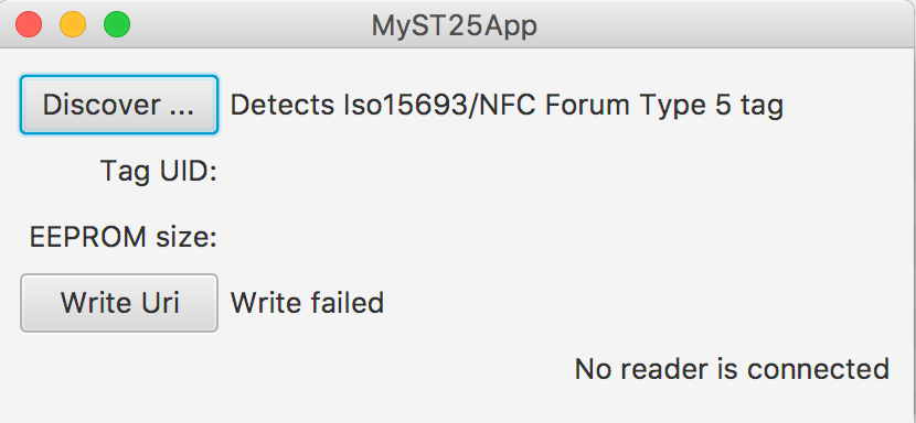

Amir Ben Ari
Posted on April 30, 2018 at 09:37
Sorry, forgot to mention that I'm using SDK version 1.1.0.
There's no Help => About when running the ST25 example Java app, but its the same one that comes with the 1.1.0 SDK version
Amir Ben Ari
Posted on April 30, 2018 at 09:39
I've run the examples Java app.
Status of ''No reader is connected'' does not change even though Reader is attached.
