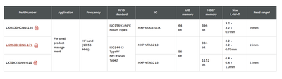

do you have any IC that can read either one of the three tags linked below?
Two of them are one frequency and the third of another frequency, we can stick to using just one frequency, 13.56MHz might be the better one.
If not, do you make any tags as small as those for which you can also provide a reader IC?
LXMS33HCNG-134-datasheet (murata.com)
LXMS33HCNK-171-datasheet (murata.com)
LXMSJZNCMD-217-datasheet (murata.com)
Thank you

Hi Ricko,
I think one of your links was incorrect:
The HF chips can be read with any reader of our ST25R reader family. Due to the small antenna of these modules the read range will likely be limited to few millimeters and maybe you want to design a reader antenna fitting these tags.
BR, Ulysses
