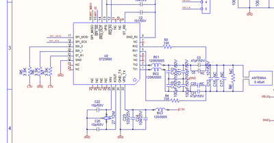

2024-11-13 05:38 PM - edited 2024-11-13 10:39 PM
this is the hardware environment
The parameters and layout, are similar to those of the X-Nucleo-NFC03A1.
I calculated that the value of my DAC-REF is 0x40 using function st25r95CalibrateTagDetector in the library
But after running this function, my antenna can no longer detect tags, which confuses me a lot。
and when I sent directly the command (>0x07 0E 0A 21 00 38 01 18 00 20 60 0x40-8 0x40+8 80 3F 08),The chip cannot be awakened by the tag either。
2024-11-14 02:36 AM
the problem had solved just now,the reason why I can't wake up st25r95 is that I used a wrong DAC_ref
