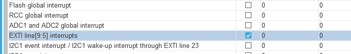

I´m using an STM32 Nucleo G474RE and an X-NUCLEO-NFC04A1 and I want to use the interrupt function of the NFC board to detect a changing field, but the interrupt doesn´t get triggered by using this code (based on a example from ST):

Okay, my own question gives me the solution. I don´t have activated the "EXTI line[9:5] interrupts in CubeMX:
The code works as expected after adding this option =)

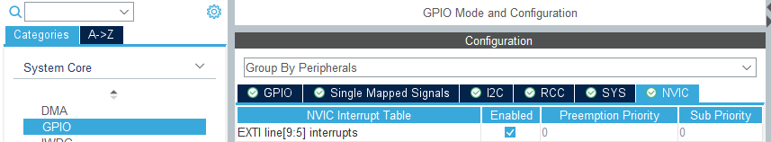

Brian TIDAL
if using STM32CubeMX, go to NVIC tab and check the Enabled box for EXTI line 5-9:
This should add HAL_NVIC_EnableIRQ(EXTI9_5_IRQn); in the MX_GPIO_Init.
if you want to check, remove the shield and its initialisation code, set a breakpoint in the EXTI9_5_IRQHandler, set a wire between PA6 and GND, run and then connect PA6 to 3V3 this should force a rising interrupt and stop the debugger in the EXTI9_5_IRQHandler.
