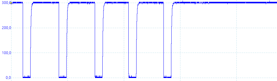

Here is a sample of the interrupts I am trying to achieve. Using CR95HF I'm writing blocks of data and the tag raises interrupts.

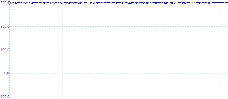

Here is a sample from my Android app. Just like with CR95HF, I'm able to write blocks of data, read the blocks to see the whole data, but unable to raise interrupts whilst writing blocks using my phones NFC component.
I have checked 4.3.1 RF WIP/BUSY (bit 3) and have read the current configuration byte of my tag. ReadCfg command retuns the value 0x0B which corresponds to 00001011b. I have been able to modify the value to 0x03 and back between/during each block and the whole writing process, but am still not able to observe forementioned interrupts.
Any help or thoughts on the matter are highly appreciated.

RF WIP/BUSY (bit 3) is part of the non-volatile Configuration byte. Therefore, it only needed to write it once. If you configure it to RF busy mode, do you see the interrupt during the various commands?
I've tested on my side with an Android phone using the ST25NFCTap app and a M24LR discovery board and I can see the interrupt on each write commands when in RF WIP mode and interrupts on various commands when in RF busy mode. Can you try on your side to use the ST25NFCTap app to send Write commands?
Also, what is the value of your pull up resistor between Vcc and RF WIP/BUSY pins?
Rgds
BT

The tests I've performed with RF WIP mode and RF BUSY mode were to no avail. So I've tried configuring other bits of the configuration byte and bit 0 of the control register byte. Have been testing scenarios on three different apps including ST25NFCTap and seeing interrupts 10% of the time.
Upon using a different android mobile device I've finally achieved consistent interrupts. But both mobile devices' NFC components feed the energy harvesting by around 3.2V so I have no idea how changing the mobile device was beneficial. Any ideas?
Notes: I was testing on a Samsung device with Android 5.0 os and switching to a Xiaomi device with Android11 os solved my issue. And it appears that I'm not using a pull up resistor, a software decides when Vcc is set to high I think. It may be the main issue that an older device couldn't raise any interrupts. Would appreciate thoughts on that aswell.
