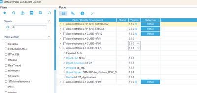

Thanks for the reply,
Alas, the only NFC middlewares available to me in the CubeIDE are the X-CUBE ones, hence my post.
Should there be other NFC middleware available?
