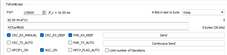

Please start from something working. A first starter would be using one of our demos. Here a recipe:
On ST25R3916-DISCO GUI with STEVAL-25R3916B: ISO14443A tab: "Configuration" and "WUPA->Active". Should show the UID
Then switch to debug tab. There you can then execute
  • TxRxNBytes with CRC_TX_AUTO=PAR_TX_:AUTO=checked: 60 04. GUI will report a CRC error but bytes are there in firmware. Alternatively:
  • TxRxNBytes with CRC_TX_AUTO=PAR_TX_:AUTO=unchecked: 60 09 44 ef 01 with 4 bits in last byte and manual RX settings:cmd6004_exec.png
    This string is equivalent to the 60 04. CRC is d1 3d and with parity you get to this string.
BR, Ulysses

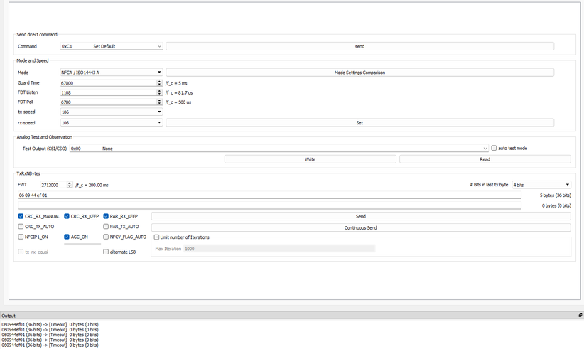

Thanks again for your earlier guidance. I wanted to follow up with some results:
  • Using the “WUPA → Active” flow in the ISO14443A tab, I successfully retrieved the UID from the tag:
UID: 4D 2C 05 10
  • The GUI reports that the transponder is not ISO/IEC 14443-4 compliant, which aligns with the tag being a MIFARE Classic or another ISO14443-A Level 1 type.

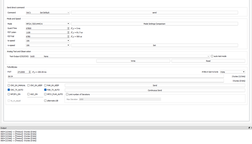

Following your advice, I attempted both REQA options in the Debug tab:
Option A: Auto CRC / Parity
  • 60 04
  • CRC_TX_AUTO and PAR_TX_AUTO checked
  • 4 bits in last tx byte
    • Result: Timeout
Option B: Manual CRC / Parity
  • 60 09 44 ef 01
  • CRC_RX_MANUAL, CRC_RX_KEEP, PAR_RX_KEEP checked
  • Auto TX options disabled
    • Result: Timeout
So far, I have only seen a response from the tag when using the built-in WUPA → Active GUI flow. That works consistently and returns the correct UID.
Please let me know if you see anything off in the manual frame or have additional suggestions for debugging the REQA behavior from the Debug tab.
- AMCI
please beware that for your target command to be accepted by the the card it needs to be in ACTIVE state. You need to go to ISO14443-A tab: Configuration + WUPA->Active. Then you can switch to Debug tab and execute one time a command as I had shown in my previous post.
You will not be able to repeat this command  or send the another command (even if not answered) - you need to go back to ISO14443-A tab and repeat the whole sequence.
With any unknown command the tag will fall out of its current state.
Of course if you receive a positive answer you could continue with the next well-formed command.
Not sure about your reference to REQA: This command (and WUPA) wakes a tag. It is not sufficient to move the tag into Active state. For the active state also the complete AC/Select procedure are required. This is what these buttons on ISO14443-A tab do.
BR, Ulysses
