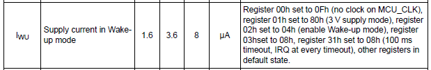

I made the changes as described and disconnect pin 2 on CN6. I then programmed the wake-up Timer Control Register (31h) with a value of 0 in order to observe the wake-up current. When I measure the current through the 3V3 line, I got 5.5µA, but the datasheet says 3.6µA. How can I get closer to that value?

Posted on March 22, 2018 at 10:18
Dear Joseph
Can you please confirm that the oscilator and mcu_clk is not turned on?
And the following conditions are fullfilled?
Which kind of amp-meter have you used?
The values for this mode would be 1.6µA min, 3.6µA typical and 8µA max.
BR Travis
