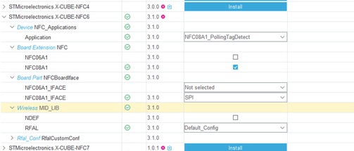

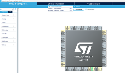

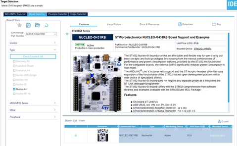

I´m tying to load and example project for my nfc kit, which if formed by nucleo-G431RBT board with 25r3916B (nucleo-nfc08A1). I only find projects for another nucleos, so i try to star a new STM32 project (STM32 Cube 1.8.0)starting from my nucleo board as the following picture.

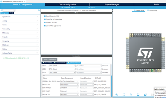

After create the project I selected the correct nfc library to my nfc nucleo in .ioc window as the following steps:

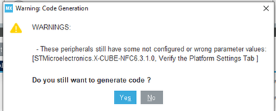

Then, i fill all the options to generate the code, however, there are some gaps that can´t be filled (found solutions of bsp api)

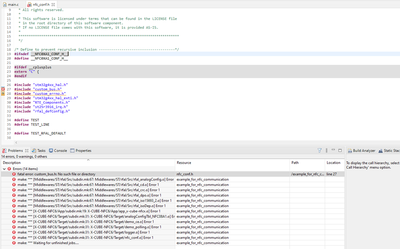

After generate the code, i try to build all code to ensure that there´s no problem, but appers two files that are called but they are not been generated, i don´t know the meaning of them or if they have to be created by other way.

Brian TIDAL
the various peripherals (e.g. SPI, GPIO, IRQ) needs to be configured. See the detailed documentation inside X-CUBE-NFC6\3.1.0\Documentation\STMicroelectronics.X-CUBE-NFC6_GettingStarted.pdf.
I would suggest to have a look inside X-CUBE-NFC6\3.1.0\Projects\NUCLEO-G0B1RE\Applications\NFC08A1_PollingTagDetect\NFC08A1_PollingTagDetect.ioc to see the various peripheral and their configuration.
