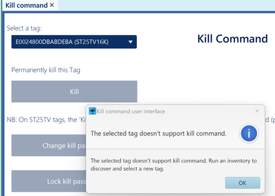

It looks like the kill command is not working for ST25TV16K. I am getting an error command as shown below:

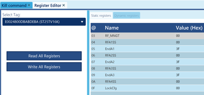

The register values are given below:

this menu is intended for tags supporting the Kill command such as ST25TV02K.
For the ST25TV16K, the kill feature is supported through registers settings i.e. the kill feature is not achieved through a kill command but through settings in register 03h (see datasheet of this product).
Therefore, the GUI behaves accordingly as the ST25TV16K dos not support the kill command. Make sure to use the registers menu in case you want to use the kill feature on ST25TV16K.
Rgds
BT
