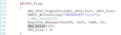

There is no specific configuration to read dynamic registers, whether they are RO or not.
Nevertheless, the IT_STS_Dyn register is special compared to other dynamic register because it is reset to 0x00 when it is read.
This means that if you read it twice quickly (quickly meaning before a new interruption occurs), the first read will give you the interruption status with correct bits set to 1, and the second read will give you all 0.
Another reason to have all 0 in the IT_STS_dyn register may simply be that the interruption has not been triggered. Are you sure that the interrupt has occurred ? Where you able to capture it on the GPO output?

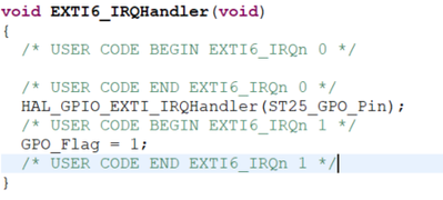

Let me explain in more detail what I’ve done. Essentially, I’m controlling the NFC07A1 board using a Nucleo-U575ZI-Q. I mapped (through STM32CubeIDE) the GPO pin to the corresponding micro's pin as GPIO_EXTI6 (PA6). At this point, I’ve activated a flag when the interrupt occurs, and in the main, I handle the function related to the flag with very simple code as you can see in the following figures:
Then, I performed various tests by setting the GPO1 register to different values to verify that the interrupt is triggered correctly. For example, I tested the EEPROM writing (RF_WRITE_EN pin) using the Android app made by ST, and then I tested for the presence of the field (FIELD_CHANGE_EN).
As you can see, I’ve enabled the function Register_Manager(0x2005, 0x02, 0xA6, 0), which is a simple function I created that allows me to read the 0x2005 register via the I2C protocol (I'm sure that this function works because I used it to read and write many registers before). However, every time an interrupt is triggered, this function always returns 0x00.
Regarding the other dynamic RO registers, I know in which situations they should change, but for both the registers you mentioned, they continue to return 0x00 when I read them after performing the actions that should change their value:
1. For I2C_SSO_Dyn I enabled the security session using the Present_Password function (which then allows me to write to registers that require a password via I2C) and then i read it, but the I2C_SSO_Dyn register continues to return 0x00.
2. For MB_LEN_Dyn, I wrote the mailbox via I2C, but it still returns 0x00. Can the mailbox be written via I2C, or does it need to be done via RF to update the MB_LEN_Dyn register??
