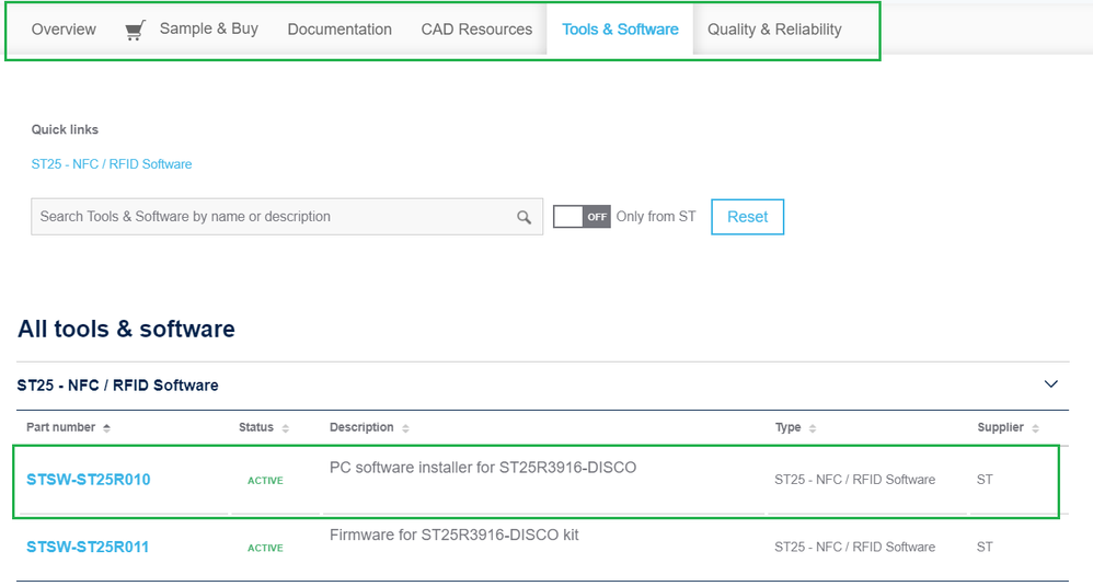

0693W000008wJfuQAE.pngBut there is not an available template/example in STM32CubeMX developed with this kit.
Actually, ST provides you with the STSW-ST25R010 PC software installer for ST25R3916-DISCO containing the ST25R3916 Discovery graphical user interface (GUI) to control the ST25R3916-DISCO board from a Windows PC.
Here also the Firmware for the ST25R3916-DISCO board User Manual demonstrating the capabilities of the ST25R3916-DISCO board and the Data Sheet of ST25R3916.
