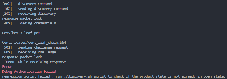

DA regression fails with timeout. I cannot recover the board.

Discovery output Discovery succeeds and shows
- PSA lifecycle: ST_LIFECYCLE_IROT_PROVISIONED
- ST provisioning integrity status: 0xf5f5f5f5
- ST HDPL1 status: 0x1
- Permission: Full Regression is listed as available
Regression attempt Using default keys from the firmware package (not regenerated):
- Key: DA/Keys/key_3_leaf.pem
- Certificate: DA/Certificates/cert_leaf_chain.b64
- Password: DA/Binary/password.bin
DA/regression.sh Result
The provisioning integrity status 0xf5f5f5f5 suggests OBKeys were not properly programmed.
Is there any way to recover this board from PROVISIONED state when DA authentication fails due to missing/corrupt OBKeys?
Thank you

Hello @obrahimo,
I'm afraid your board may be lost, as the DA Auth shares storage space with the OBK. And without successful authentication there's no regression.
