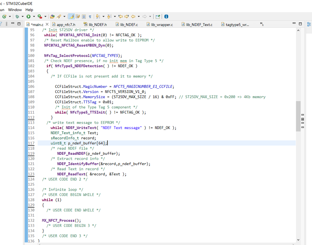

Brian TIDAL
see MX_NFC7_NDEF_URI_Init function.
You can customize this code to write your own URI.

I took your advice and wrote a text message, but the phone ST25 Tap APP does not show any NDEF information, what should I do?0693W00000aJKfzQAG.png
